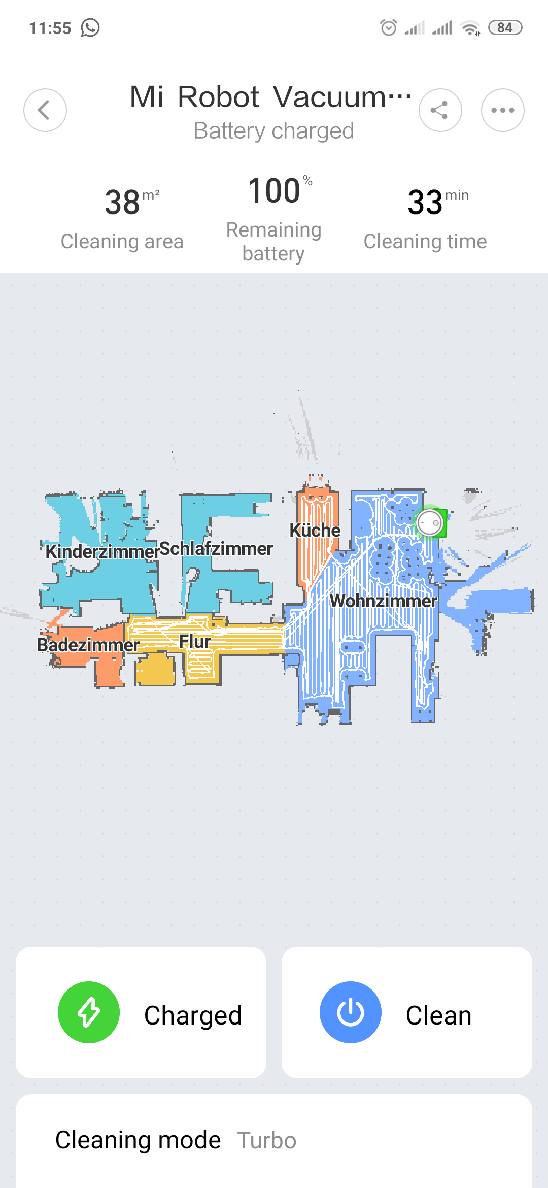

I removed certificate pinning from xiaomi smarthome app and captured data.
There is a lot of data but maybe the following is intressting:

The clean_area\":2565000 changes every time if I start an cleaning by room.
So every room has an unique ID.
Can some pls help to implement this ?
