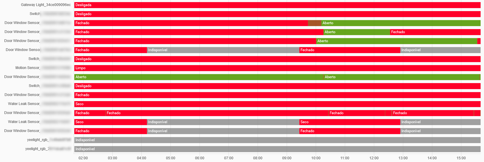

This normally happens with other deviced, (Sensors and Switches), but with Yeelight I’ve never been able to configure it. I’ve even flashed the card again, to start again
This is my History report from Xiaomi devices:
