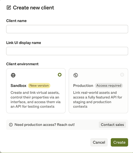

Hi, I wonder if you had to reach out to sales to get access to enode production .

my account still hasnāt been changed to production

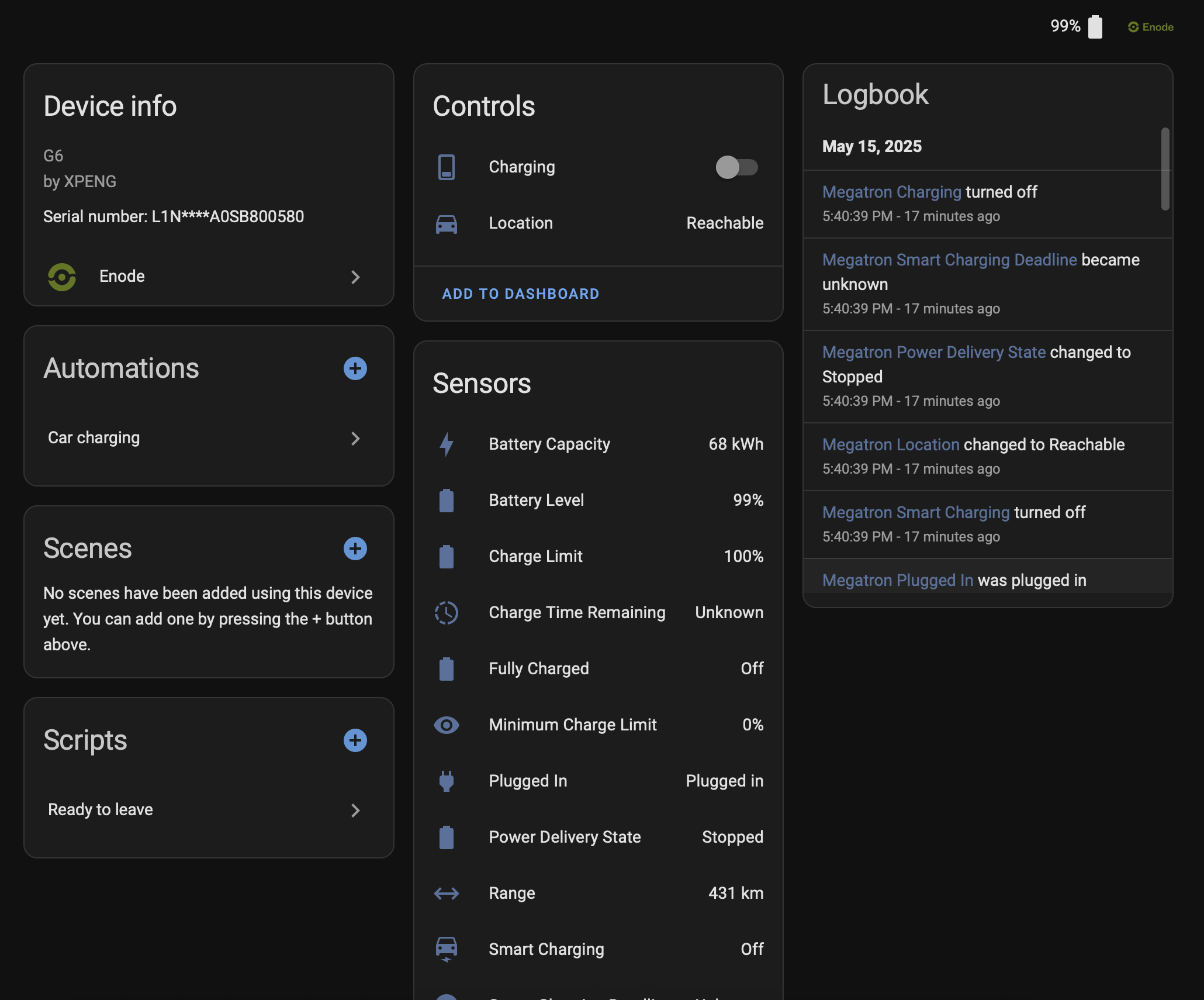

Hey folks. I stumbled upon this conversation about integration Xpeng with Home Assistant. Not being the kind of person who does things in halves I ended up creating an Enode integration. Iāve got it working with my car and can even turn on and off charging. Some of you may find this useful and for those that do would appreciate any feedback.
Great, personally Iām waiting for my enode login to go into production, Iāve made several reminders without a response. Could you make your integration available? How did you manage to get a production log for enode?
I emailed them twice. I didnāt hear a response the first time after a week so I emailed them again. I was working on the integration in the meantime and made it support their sandbox mode so I could make sure it was all working. After the second email just on a whim I logged back in and went to create another client via their dashboard and the production option was no longer greyed out.

If I were you I would check the dashboard if you can create a production account or not. If itās been a week since your email I would then try again. Good luck.

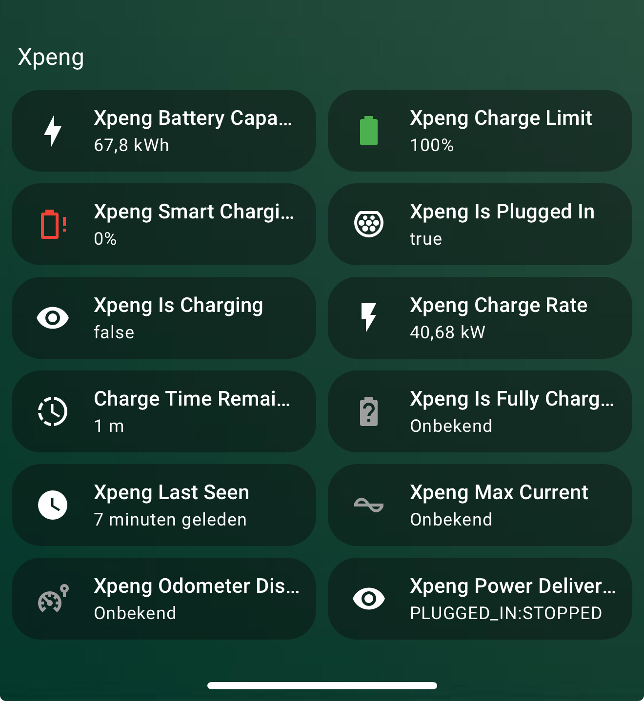

I also made an integration for Enode.

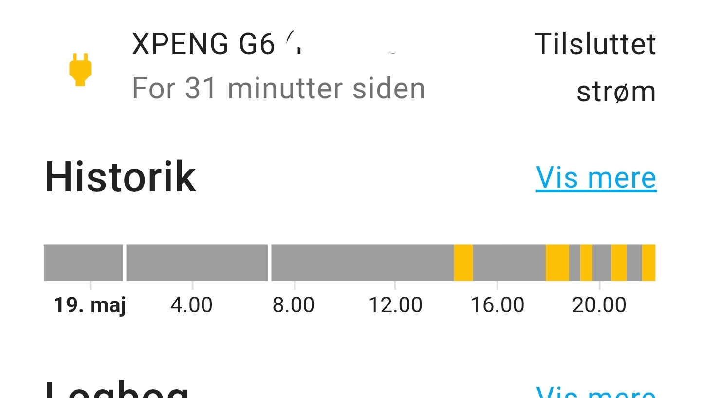

Do you have the same issue, where the plugged in status changes between on, off and unavailable, even though the car is plugged in?
This is due to the car going in deep sleep mode, since activation of sentry mode or 12V power plug, keeps it online/plugged in.
Enode however says that it is not a general Xpeng issue. But it is not my integration, since status is the same in Enodes webinterface.
It it really annoying, since its not possible to turn on charging when status is unplugged, and hence makes it unreliable.
