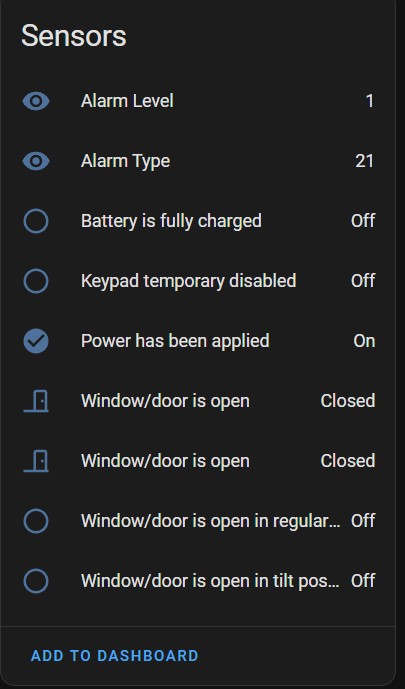

One thing that’s problematic is the lack of seeing the door sensor in Home Assistant, so I can’t automate the control of the lock. The way it works in their software, it will set a timer, and then force the lock to close even if the door’s not 100% closed or if it’s in the open state. Super annoying!
Looks like there are sensors for what should be the door, but they never change:
Might be a Z-Wave bug or something to do with Z-Wave JS.
