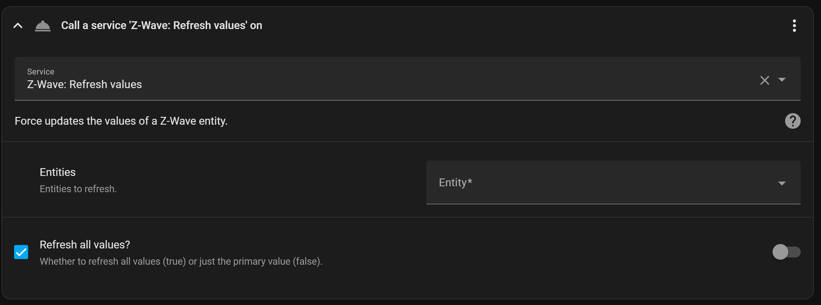

To setup polling in the action section of your automation select service as your action type. Then select call service. Then select the Z-Wave: Refresh values service. Then select the entities you want to poll.
