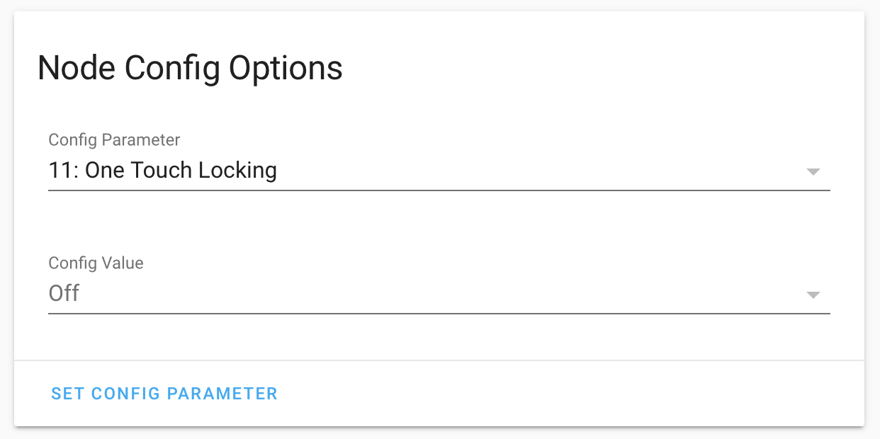

Have any of you noticed the “Node Config Options” show the incorrect “Config Value”? Here’s a screenshot of what I’m referring to from the Z-Wave config page:
In the above screenshot, it shows the “Config Value” set to “Off” when in actuality, it’s “On”. It’s the same way with several of the config options. Does the Z-Wave module not read/report the settings of the lock?

Just curious if there’s any Yale Assure SL users here that have the “Node Configuration Options” that actually match what is set in their lock. See my post above. Most of mine don’t seem to match.
