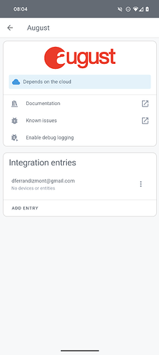

A question for those who managed to setup and control the lock through the wifi bridge. After attempting to set up the “Yale Access Bluetooth” (I managed to set it up, but the connection is not stable and it constantly disconnects from the bluetooth controller, I assume because of some incompatibility with my dongle, and already have ordered another model), I tired to set it up through the bridge and the August integration. I have set up everything int the app and the lock is accessible from anywhere, but when installing the August integration it doesn’t populate any devices or entities. And I can’t understand what’s the reason. Any thoughts?
If the lock was not discovered by Home Assistant when the cloud integration was loaded, reload the cloud integration once the lock has been discovered.

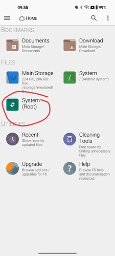

Can you please help me, I got a rooted android and the Yale Home app as well, but when I try to go to the path provided, I can’t see the Yale app in the list. I only see com.google.android.gms and my file explorer app. Any idea?
Which file explorer are you using? You need to use one that allows you to see protected folders, like FX with the root add-on installed. By navigating to the mentioned folder, you will be granted root access and be able to see all the folders, including the Yale one. Just let me know if you have any problem.
I tried a few different ones that allow root access, while I do see root folders, I don’t see the yale app. Tried CX File Explorer, Root Browser and File Manager for Superusers. I did create the automatic unlocking feature.
