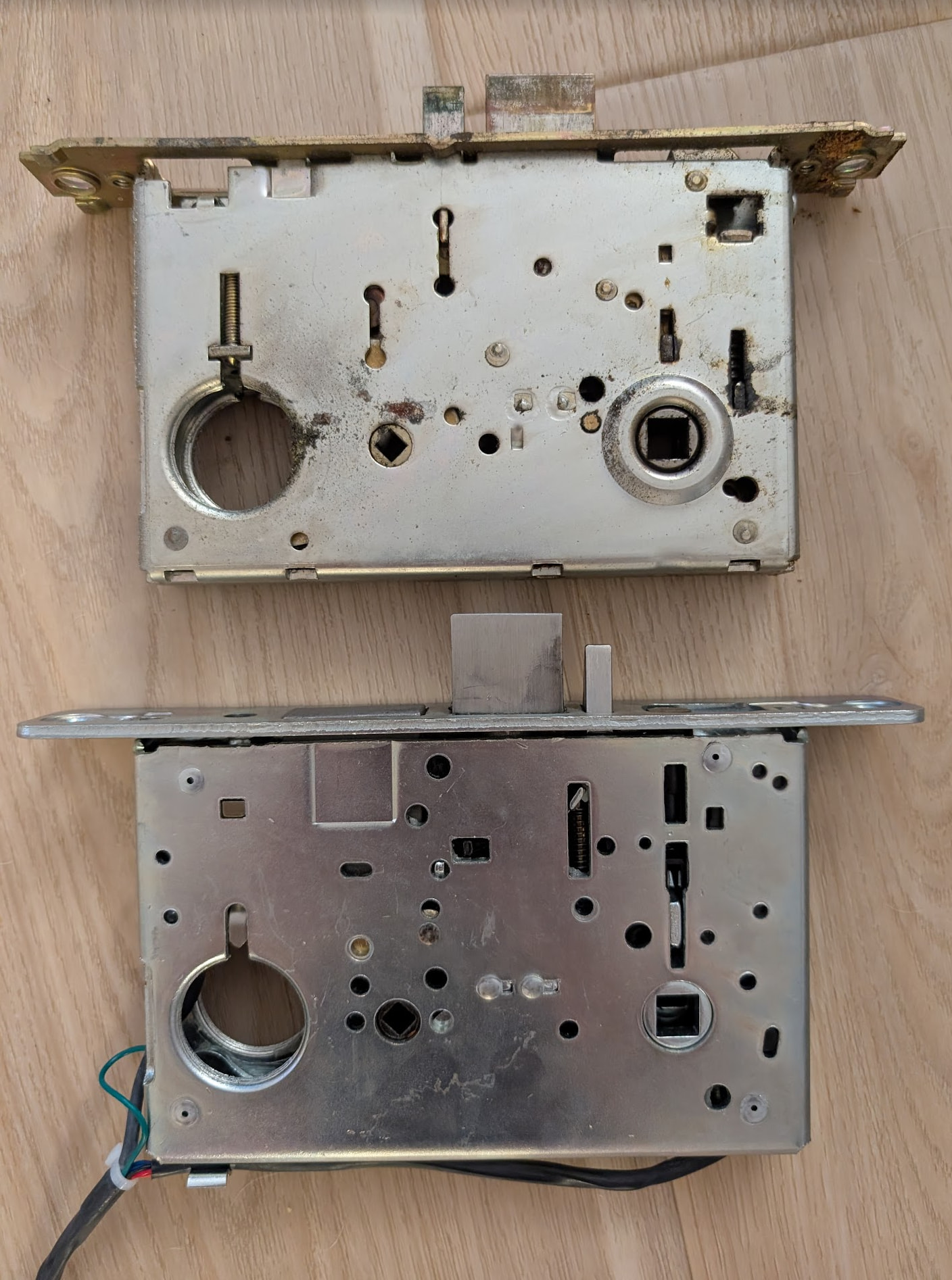

Top is the original and bottom the 617:
Original interior
New 617 interior:

The mortise footprint of the old Yale 8820 and the new nexTouch are nearly identical.

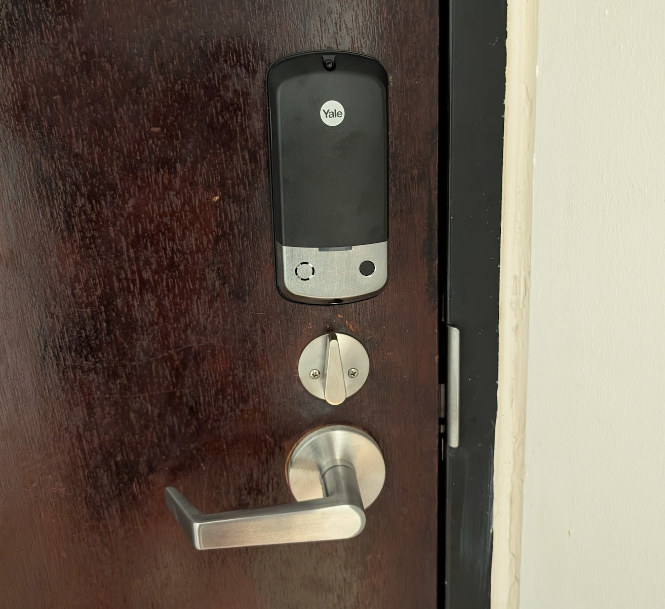

  1. I set up a master PIN on my workbench using the keypad, then simply didn't install the keypad on the door.
  2. I reused my original exterior handle/rosette. Everything on the exterior looks identical to the 1980s original.
  3. I drilled one single hole in the door to route the data cable from the mortise cassette to the interior battery/radio box.
