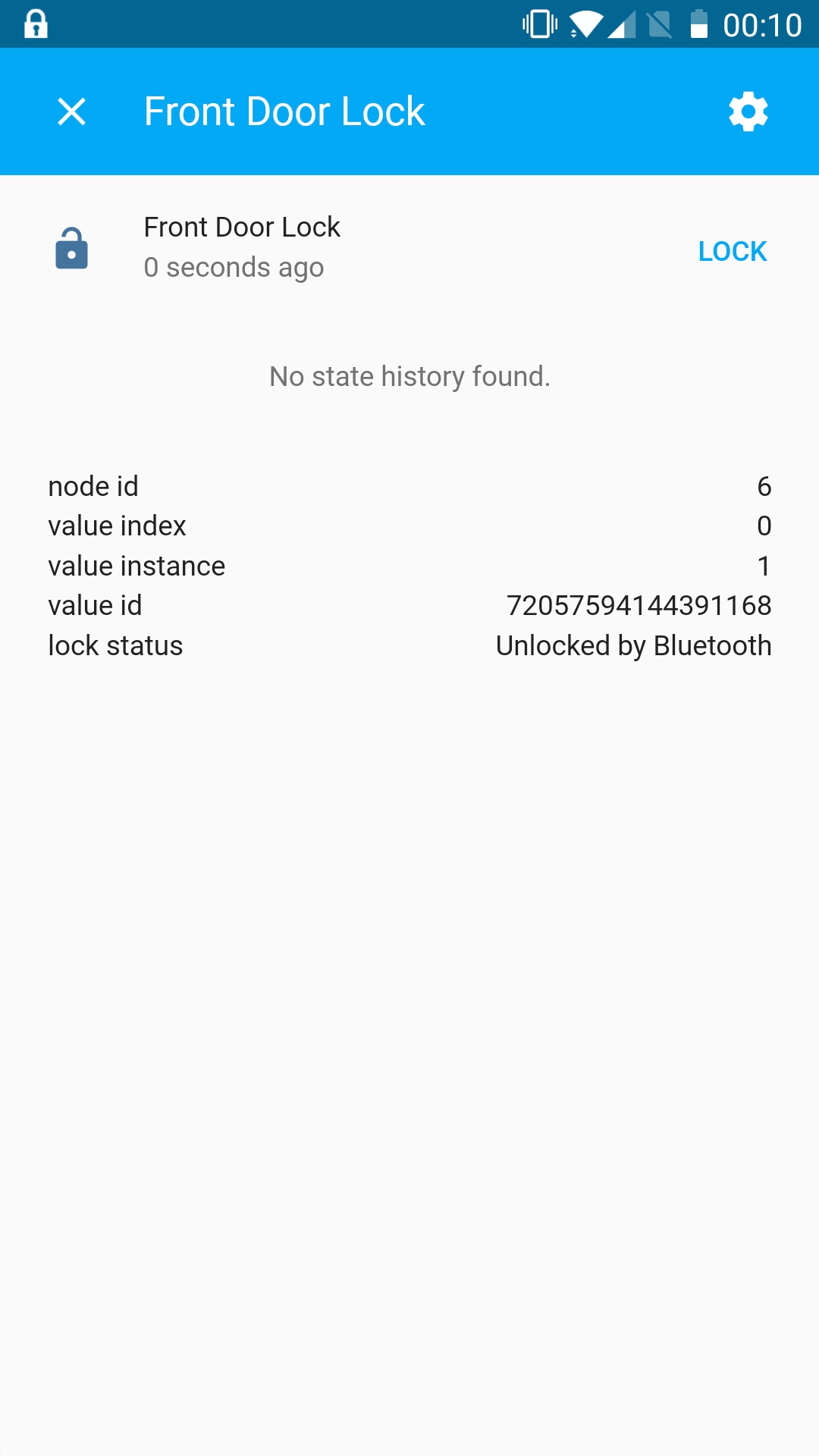

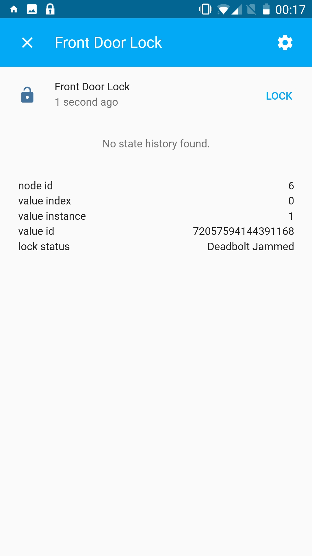

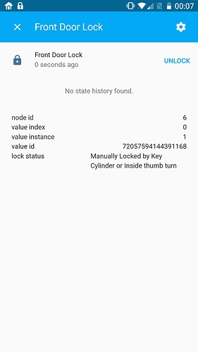

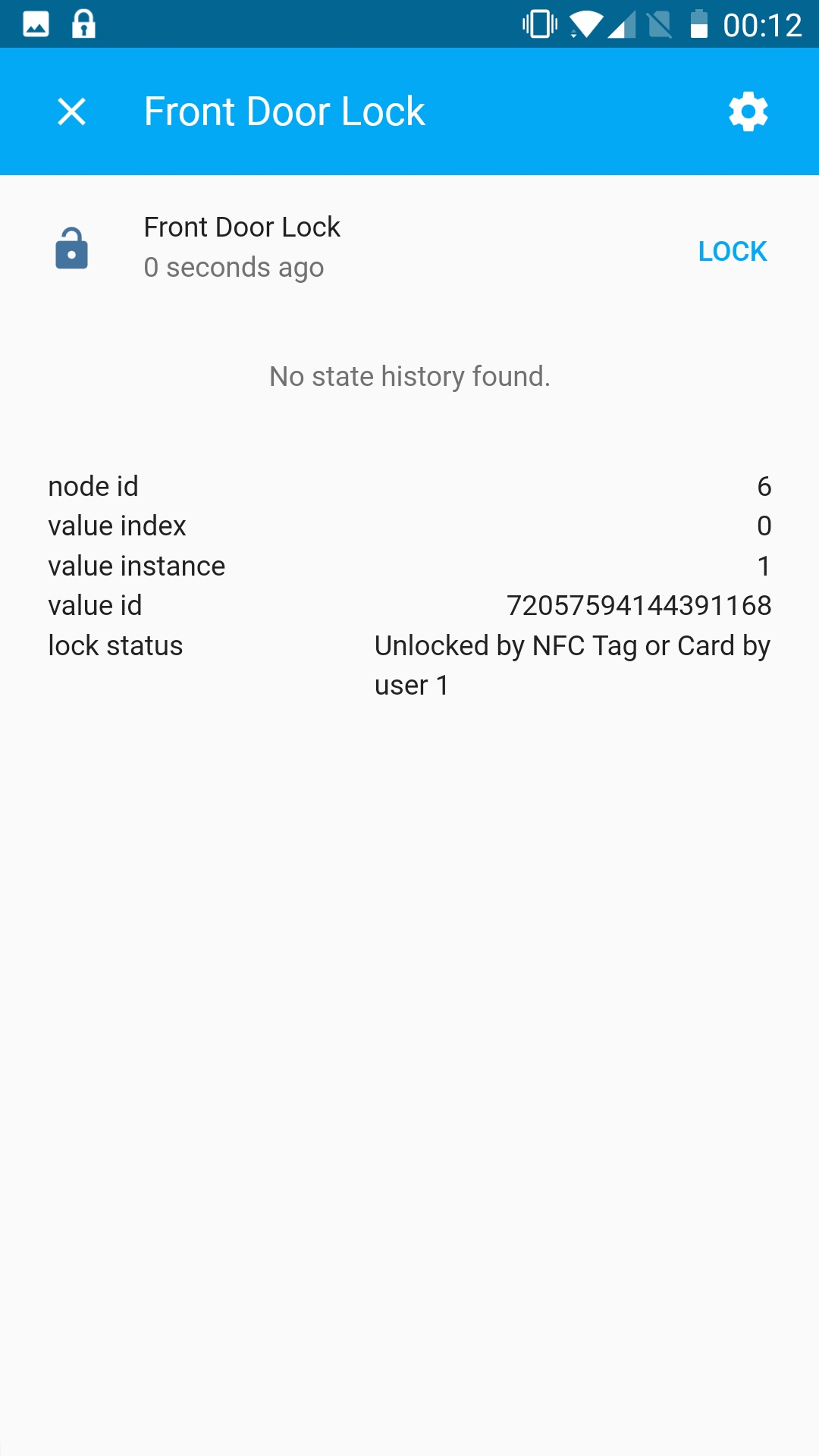

I didn’t go to bed yet. Thought you might be interested to know that I get good statuses from the device in the app such as just how it was unlocked:
