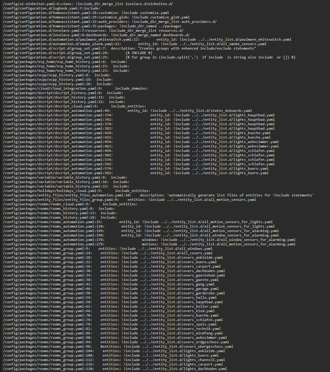

You didn’t do as I asked. You searched for include. I said search for include:.
Anyways, the benefit of searching for include: is that you can see where that key exists in your configuration and you can remove it or handle it.
Again include is not deprecated. So !include will continue to work. The error message / config error is about the key include: which is linked to an integration. Once you figure out which integration that is, you can alter the yaml to the include: replacement.
Thanks for the explanation - where do you know from this is coming from an integration and why do you know that it needs to be include: (since the initial error message shows ‘include’ not 'include: ?

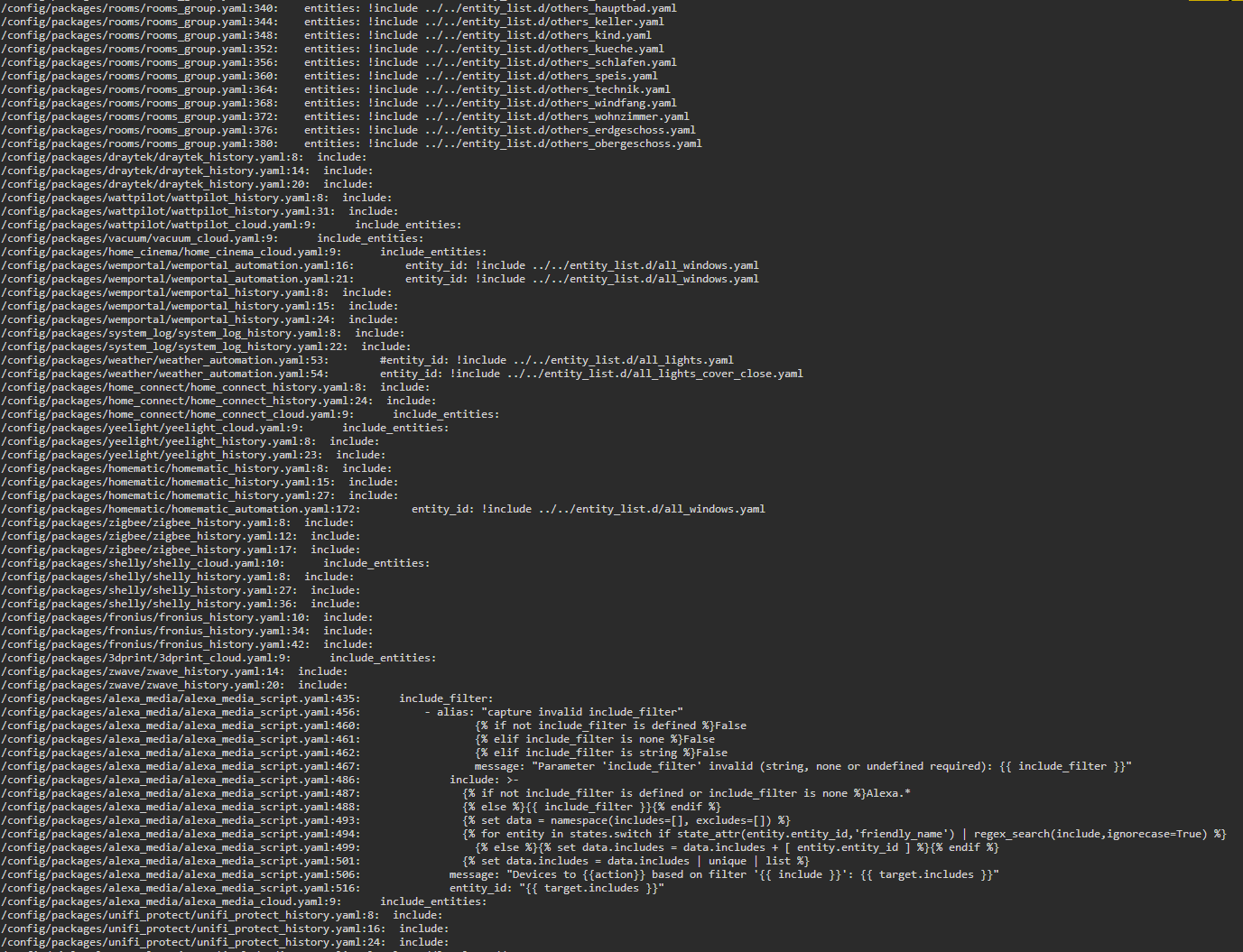

most of the ‘include:’ results are from ‘logbook’, ‘history’ or ‘recorder’ since I only include there what is really needed. But I could not find any deprecation notice of this
Because, config validation does not know about !include. That’s a function that merges configuration. Config validation validates keys in your config, i.e. include:.
Right, that means you need to grep your config for all include: and find the one where the deprecation exists.
