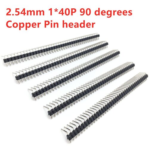

Here’s a dump of some parts on Ali I really like. They are old links so search around for newer/similar.
Double row and right angle headers:
