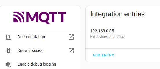

Well if it looks like this, it should work…

Thanks very much, but my level is not enough for this. I don´t see what you mean.
Don´t waste your time. I think I´ll look for a more easy solution than HA to control MQTT devices
