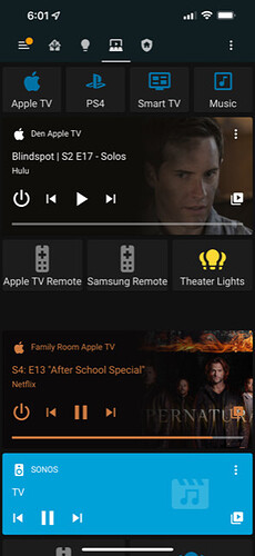

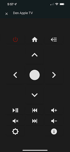

Adding this to help others who need a simple popup remote control solution. In order to use this you’ll need to install:
HACS and the following custom repositories via HACS
Browser Mod (for the custom popup cards)
Button Card (to manage all the buttons)
Layout Card (for the layout of the remote buttons)
Apple TV Beta (if you have an Apple TV)
It’s a simple solution, but getting the popup working and the layout correct was a bit of a pain. There are probably a handful of ways to do this better, but they’re all beyond me. Hopefully someone can copy/paste this down the road and save some time. It uses a grid function via the custom layout card to help keep the buttons neat. The custom grid was used to get control over column width. You could use a regular Lovelace grid, but your remote will end up looking pretty large. That may be desirable, I suppose. With the custom grid and custom column widths you’ll need to manage the margins so the button layout is centered on the popup card. Excuse the terrible TV content on the media entities.
type: custom:button-card
show_name: true
show_icon: true
color: grey
name: Apple TV Remote
icon: mdi:remote-tv
tap_action:
action: fire-dom-event
browser_mod:
command: popup
title: Den Apple TV
card:
type: custom:layout-card
layout_type: grid
layout:
grid-template-rows: auto
grid-template-columns: 30% 30% 30%
margin: 100px 0px 0px 35px
cards:
- type: custom:button-card
color: maroon
icon: mdi:power
show_icon: true
show_name: false
tap_action:
action: call-service
service: remote.send_command
service_data:
command:
- home_hold
- select
entity_id: remote.den
icon: mdi:home
show_icon: true
show_name: false
tap_action:
service_data:
command: home
icon: mdi:backburger
show_icon: true
show_name: false
tap_action:
service_data:
command: menu
- type: custom:gap-card
aspect_ratio: 1/1
icon: mdi:chevron-up
show_icon: true
show_name: false
tap_action:
service_data:
command: up
aspect_ratio: 1/1
icon: mdi:chevron-left
show_icon: true
show_name: false
tap_action:
service_data:
command: left
aspect_ratio: 1/1
icon: mdi:circle
show_icon: true
show_name: false
tap_action:
service_data:
command: select
aspect_ratio: 1/1
icon: mdi:chevron-right
show_icon: true
show_name: false
tap_action:
service_data:
command: right
aspect_ratio: 1/1
icon: mdi:chevron-down
show_icon: true
show_name: false
tap_action:
service_data:
command: down
icon: mdi:play-pause
show_icon: true
show_name: false
tap_action:
service_data:
command: play_pause
icon: mdi:skip-backward
show_icon: true
show_name: false
tap_action:
service_data:
command: skip_backward
icon: mdi:volume-plus
show_icon: true
show_name: false
tap_action:
service_data:
command: VolumeUp
device: '68973473'
entity_id: remote.harmony_hub
icon: mdi:volume-mute
show_icon: true
show_name: false
tap_action:
service_data:
command: volumemute
device: '68973473'
icon: mdi:skip-forward
show_icon: true
show_name: false
tap_action:
service_data:
command: skip_forward
icon: mdi:volume-minus
show_icon: true
show_name: false
tap_action:
service_data:
command: VolumeDown
device: '68973473'
icon: mdi:brightness-5
show_icon: true
show_name: false
tap_action:
service_data:
command: picturemode
device: '68813604'
icon: mdi:information
show_icon: true
show_name: false
tap_action:
service_data:
command: info
device: '68813604'
