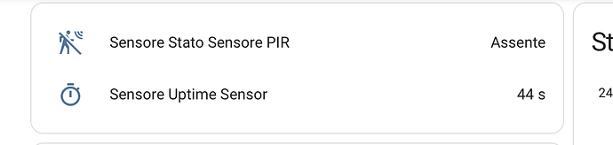

ok Neel , thank you . At the moment on the fly I installed uptime sensor on another esp32 device for testing and it appears as in the image. So as soon as I change the esp32 of the victron, so if you reset the total counter as it sometimes does, what value should I read on uptime? Thank you very much at the moment.
The uptime sensor shows how long it has been since the device restarted.
I suspect that the issue you are seeing with the total counter resetting is because the device is restarting (unexpectedly) and you do not have the integration sensor configured to save its value. So, when the device restarts your counter resets. The uptime sensor will either show what I said is likely or that it is not correct. Without the data, it is just a guess/hunch.
