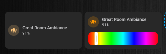

The only reason I delve into this stuff is because HomeAssistant doesn’t give you the UI to customize it. They only expose a bare minimum and you need loads of plugins from the community store, all because they don’t give a shit about exposing things like a color selector, rgb & white brightness in a light.
They have the code for it in a stupid light popup that’s 3 clicks away, (massively inconvenient) but they don’t expose it via a tile feature and they sure as hell don’t allow you to present that as a wheel, slider in hsv / rgb values or style it in any way.
So instead they force this hell upon you, where you need to create helpers for each light, add plugins, add yaml, add css and then maintain it in each overview tab. Just to have a somewhat decent UX.

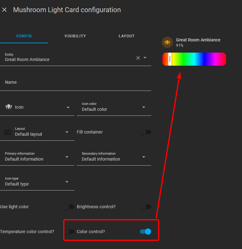

Custom mushroom card which looks almost identical to tile card supports this with the UI, no yaml needed.
And before you complain about using a custom card, the developer of custom mushroom card works for home assistant and is working towards getting that color slider into the tile card.
