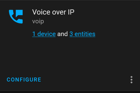

This is my “voip-server”:
you add to you intergrations.
again i did not set anything in mizudroid, just install it and “dial” the “number” (sip:[email protected]:5060)
