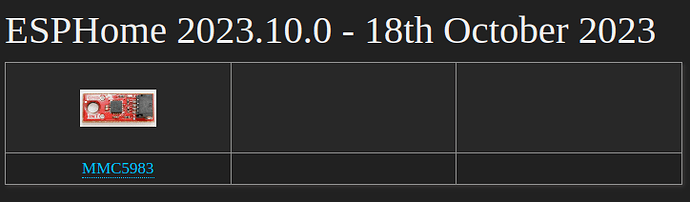

Also, your error shows an issue with strapping pins.
I remember, that I read something about this in one of the release notes recently…
- Incorrect ESP32 Strapping PIN Defined esphome#5563 by @descipher
I just looked at that PR which states that GPIO4 should actually be 5, but GPIO4 or GPIO5 aren’t used in the config for the ESP-box so I don’t know why it would throw that error, unless the code has been updated to remove either of those.

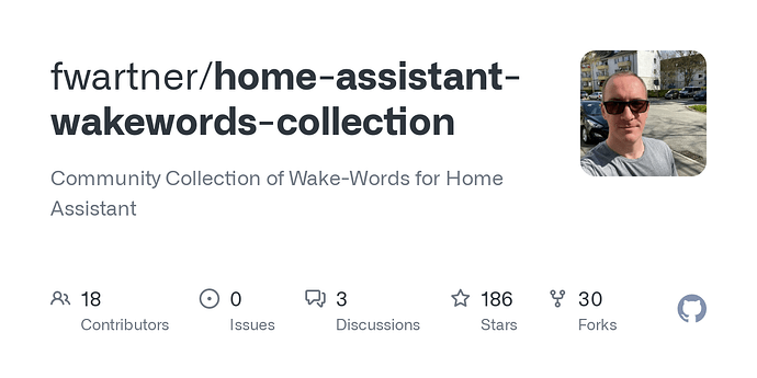

Hello everyone. Thank you for all your hard work to make this happened( voice assist and wake word). I am not a programmer and don’t know how to create a custom wake word, maybe someone will create and share with me and the others who is interesting in this type of wake word . My idea is to use a Capitan Morgan bottle with esp32 board , mic and speaker inside for Voice Assist, to blend with my BAR collection. And I would like to use a wake word like : HEY CAPTAIN or HEY MORGAN or maybe AHOY( like a pirates ). My esp 32 board is up and running and I am in the process of empty
my rum bottle and build a voice assist. Thank you in advanced.
I saw that one, thank you and I use his terminator word to try ow it’s work. And it’s working great, but I have no idea how to create one with my own wake word. I read an instruction, but so far is not what I am capable to do by myself. Thank you again
Instructions: Create your own wake word - Home Assistant
