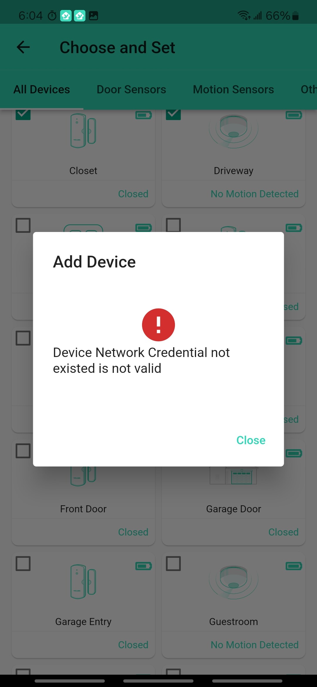

I also have 2 devices that I couldn’t add, one being the leak sensor I already mentioned and the other being a different contact sensor. I get this message when trying
Edit: I think I should mention this too. Matter stops running like 3-4 times a day for me. It feels like it can go 6-8 hours before it crashes and then all my devices become unavailable in HA. I wish we could make use of the Local API right now because their Matter integration is not ready.
