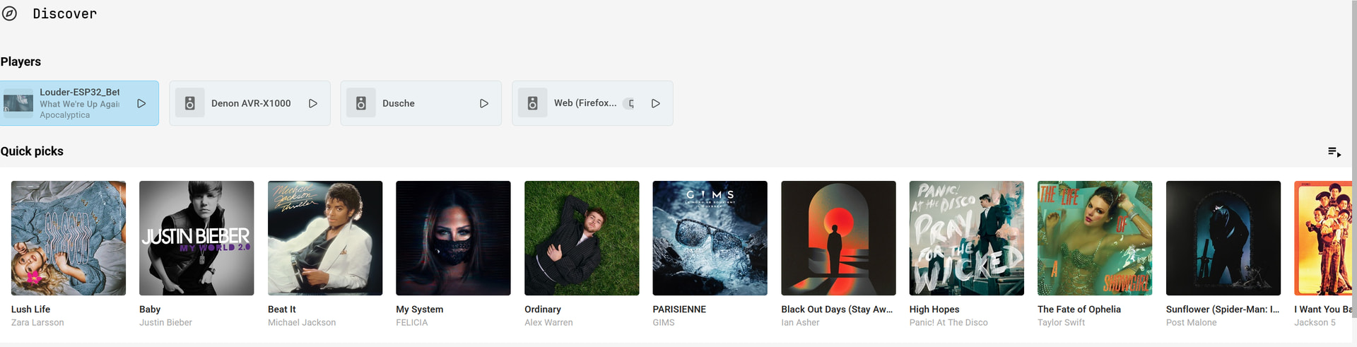

That means it should work right?
Because the quick Picks are full of bullshit ^^
Edit: Lol okay, i'm actually on a "Brand" account...
Maybe you could enhance the Readme that the "ID" is in the Url on the google Account settings. And not in the Page anywhere.

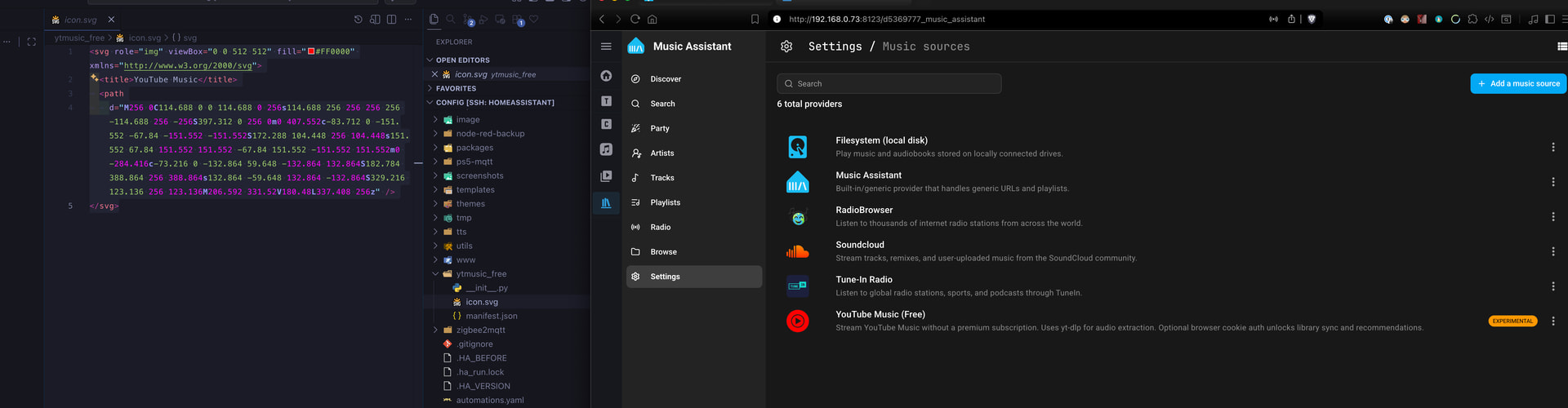

Just add any svg named icon.svgto ytmusic_free folder..
<svg role="img" viewBox="0 0 512 512" fill="#FF0000" xmlns="http://www.w3.org/2000/svg">
  <title>YouTube Music</title>
<path
d="M256 0C114.688 0 0 114.688 0 256s114.688 256 256 256 256 -114.688 256 -256S397.312 0 256 0m0 407.552c-83.712 0 -151.552 -67.84 -151.552 -151.552S172.288 104.448 256 104.448s151.552 67.84 151.552 151.552 -67.84 151.552 -151.552 151.552m0 -284.416c-73.216 0 -132.864 59.648 -132.864 132.864S182.784 388.864 256 388.864s132.864 -59.648 132.864 -132.864S329.216 123.136 256 123.136M206.592 331.52V180.48L337.408 256z" />
</svg>

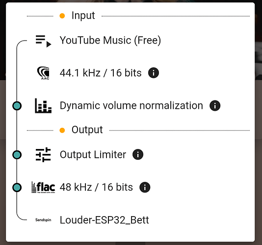

Also, the playback is showing as Low Quality even though I ticked the Prefer Highest Quality

Low Quality label: That "LQ" indicator in MA is based on what MA reports back from the stream metadata, not the actual bitrate. The android_music client we use returns 128–256 kbps AAC/Opus, which MA categorizes as "low quality" regardless of the toggle. The toggle controls yt-dlp's format selector (m4a/bestaudio/best vs worstaudio/worst), with it on, you're getting the best available audio. The label is just MA being strict about what counts as "high quality" (typically lossless / hi-res).

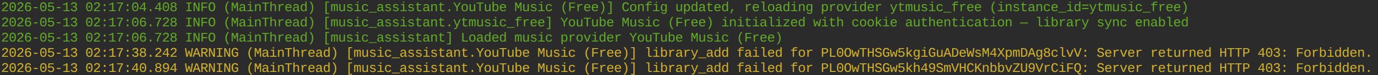

Hi, Hope I done this correctly.
It was actually ha addons logs d5369777_music_assistant | grep -i "ytmusic_free\|library sync\|youtube music" | tail -30 because I'm using terminal addon
I'm also getting this in MA log
026-05-13 02:26:03.033 INFO (MainThread) [music_assistant.streams.audio] Start Queue Flow stream for Queue JBL PartyBox @ BT_Bridge - crossfade: disabled

This could be a potential bug. Be fore I try to fix this. I have some follow up questions, but I don't want to bore the people here. We can continue the conversation there:
But the quick questions are:
  1. Did you enable the Sync Library Playlists in the options?
  2. Have you done a reinstall, before posting this error log?
Thanks for your help.
