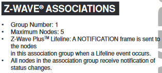

The DZ6HD manual association section:

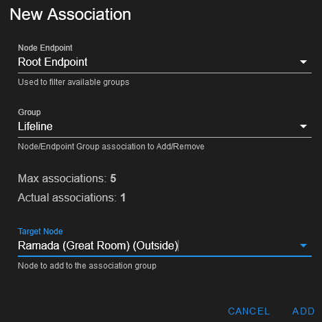

Add an association from the bathroom light (node 60) to the great room light (node 61):
Appears successful in the log
The association is shown in node 60
Nothing happens with the opposing light when I change the light (app or physical):
I tried adding bi-directional associations, with the same non-response.

Read the description of the group again a bit more closely:
All nodes in the association group receive notification of status changes
In other words, this groups is meant for Controllers (hence why it’s the “Lifeline” group) to receive status updates. There are no control commands being sent, therefore you can’t control other devices with that group.
Supporting devices usually have one or more (non-Lifeline) groups dedicated to controlling other devices. See for example a Zooz ZEN72.
