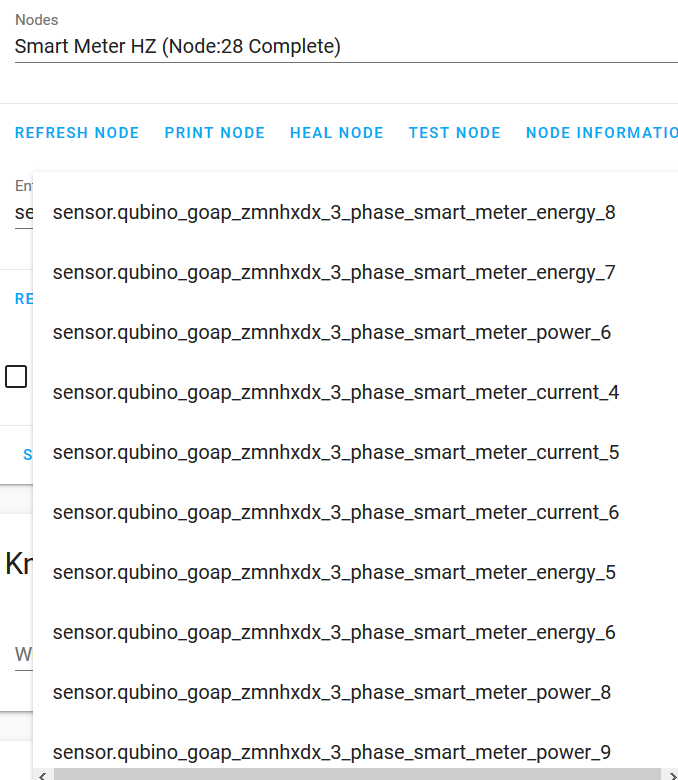

The Topic is ralated to the smart meters, in my case to the qubino zmnhtdx and zmnhxdx.
The import and export values will be presented in the same entities:
sensor.qubino_goap_zmnhxdx_3_phase_smart_meter_energy_7
or for the other meter:
sensor.qubino_goap_zmnhtdx_smart_meter_s4_s5_s6_energy_2

So how it is possible to distinguish between the import and export values and create an entity for each value of import and export?
Following silabs Z-Wave Application Command Class Specification the values send from qubino device are correct:
0x32 ID 50 Command Class Meter
0x02 Command Meter_Report
_____Scale2(1)__Rate Type(2)__Meter Type (5)
0x41 0_________10___________00001
_______________Export_______Electric meter
or
0x21 0_________01___________00001
_______________Import________Electric meter
_____Precision(3)_Scale1(2)___Size
0x24 001_______00__________100
_______________kwh
It would be nice to get a hint to fix this.
thanks a lot!
