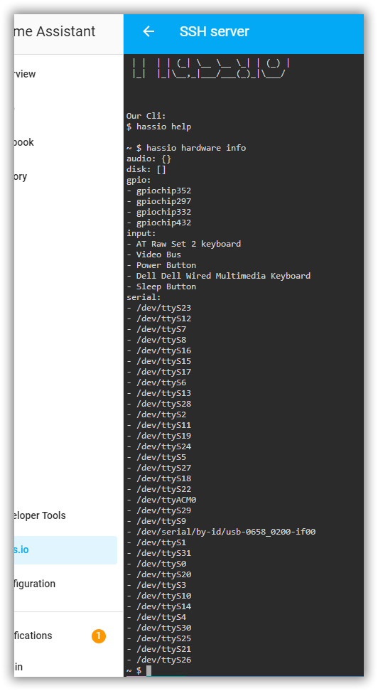

Are you sure you have to do anything special to pass in the USB device? I though the Hass.io supervisor does everything for you. It certainly will not pick up your custom udev path though. Did you try listing the devices already, as the instructions suggest? Does it show anything?
Also, make sure you follow the instructions to disable ModemManager, or you will have a lot of trouble.

Did you disable modemmanager as mentioned?
i now have, but the same error in the log.

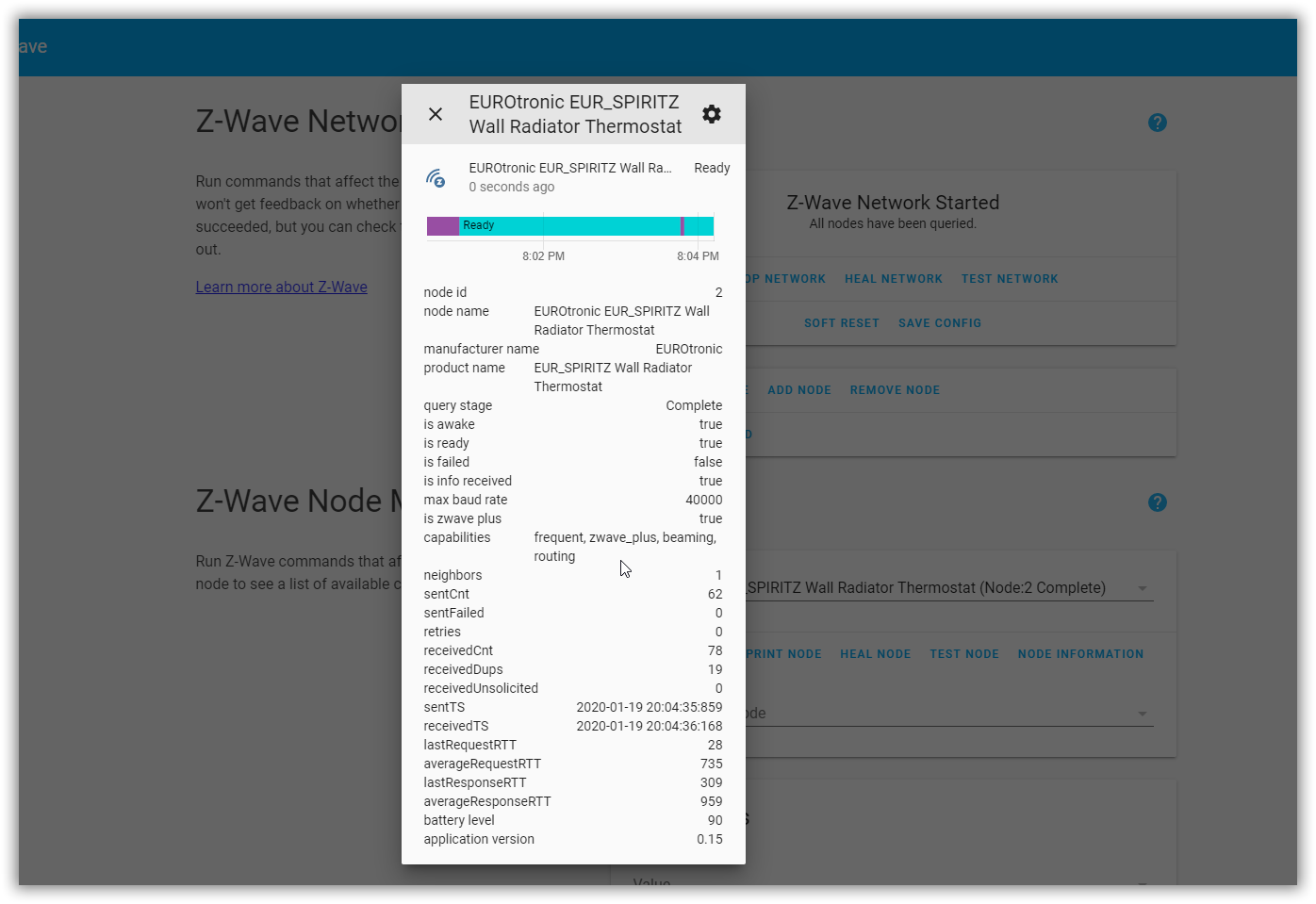

i think it is working. i’ve rebooted the complete host. so after disabling the modem manager. it looks like it is working. ill try to add a node
yep working. so disabling the momdemmanager dit the trick.
with using this as path.
zwave:
usb_path: /dev/serial/by-id/usb-0658_0200-if00
thanks everyone and specially freshcoast :wink:
