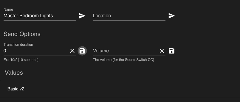

you can also do this in the zwave switch settings
