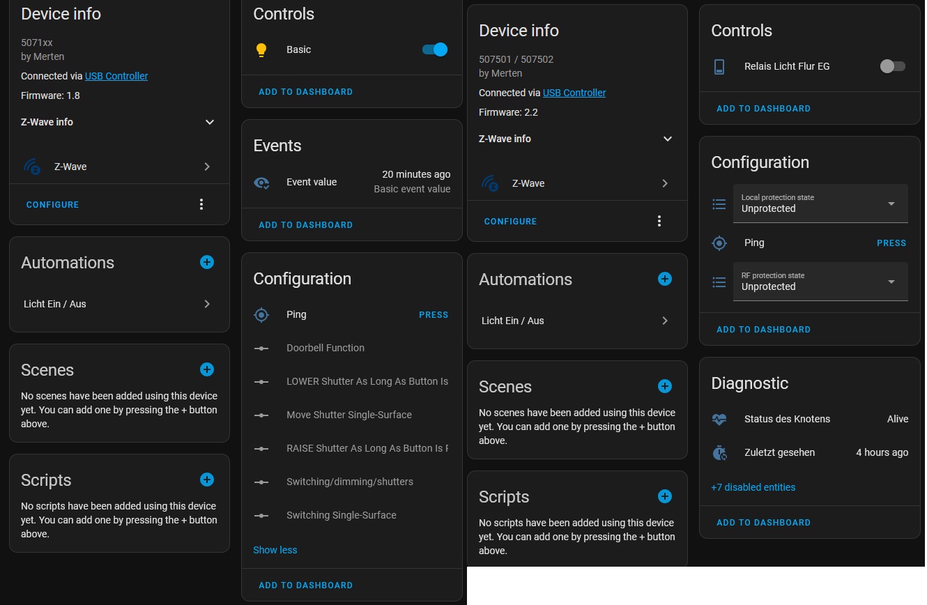

You can distinguish the top button and bottom button to set basic event on Endpoint 0, when you create a event.
Value 0 is the bottom button, and value 255 is the top button.
In the attachment is a screenShot of one of my events. double switches and single switches events are about the same:
