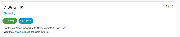

Zuser
(David)
August 15, 2025, 10:56pm
10
Many thanks, Francis! That did it. The add-on is now at 0.21.
