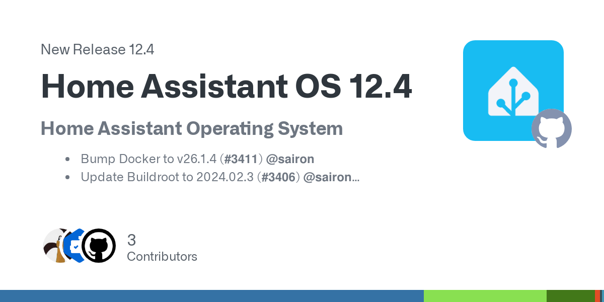

Not sure which version you are running or if you’ve seen this.
I downgraded 1-2 versions and everything works fine.
I have not upgraded or looked to see if this has been resolved.
