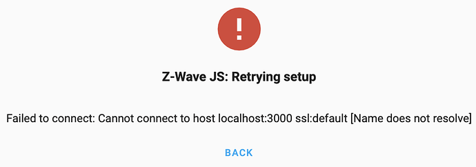

I just suffered a power outage spanning 2+ days. When everything came up, Home Assistant failed to connect to Z-Wave JS UI running in a Docker container (as is Home Assistant).
I’ve already reloaded, restarted the containers, pulled the latest images, and restarted the entire Raspberry Pi 4 (running Alpine Linux) multiple times.
Z-Wave JS UI is running and reachable as well, all the sensors show up as usual.
The error I’m seeing in Home Assistant is localhost:3000 ssl:default [Name does not resolve] and the strange part is that I can access localhost:3000 from the host itself reaching the Z-Wave JS UI Docker container.
Is there something that would cause Home Assistant to be unable to resolve localhost? Never in my life have I seen anything be unable to resolve localhost (considering it’s just the loopback right?).

How can I change it from localhost to 127.0.0.1 from Home Assistant? It doesn’t give me an option to configure it because it’s not working. It shows this:
