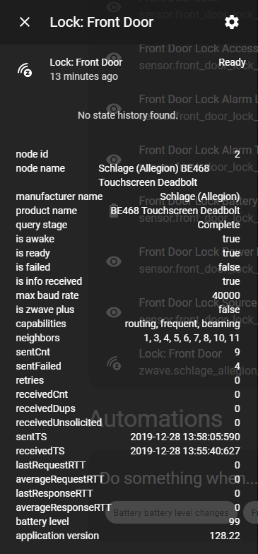

My Schlage BE468 Deadbolt has been working without problems, and suddenly yesterday I noticed its status was “Unknown”. I am using Home Assistant’s built in Z-Wave manager with the AEON Labs ZW090 Z-Stick Gen5 US.
So I did some poking around on the Z-Wave Integration page noticed the “Lock Jammed” notification. It may have felt a little bit sticky at first. But it is operating freely now and the motor sounds normal when opening from the keypad. Does anyone know how to clear this error?

The status isn’t updating. It is moving freely, and it is not having any problem manually turning or turning when a keypad code is entered. I feel like it is stuck in a confused state. I’m wondering if I need to exclude and include it to reset it?
