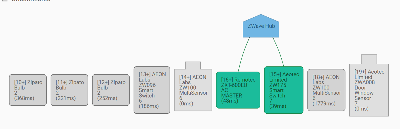

My z-wave network respond very slow, so I installed z-wave graph to see the connections.
This is what I saw on the graph:
Is the slow z-wave network is because the nodes are not connected?

I moved smart switch 7 to a different location, and now this is what i get:
All battery powered are not connected.
my z-wave is still very slow.
You need more mains powered devices - aka routers.
Should this speed up the response of the network when used from hass?
Probably, because stronger signals also means lower delays.
