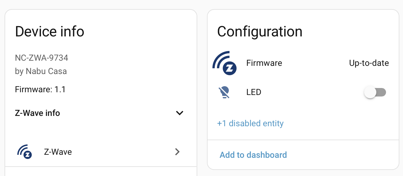

  • Will I be able to turn the darn light on top off when connected through ZwaveJS-UI? I do not want a giant pole to light up the night. Even if there’s some kind of error.

The led on top can be turned off.

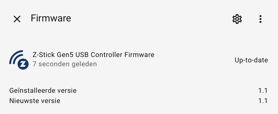

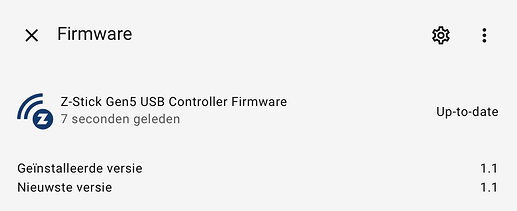

wait, I now review this, and see the mentioned update is for a version V1.02 firmware.
mine mentions 1.1 though. so how is that an update? do I even need it in that case?
or, is the official Aeotec website erroneously showing V1.2 as V1.02 for the ZW090 controller…
I think that’s a typo on the Aeotec website.
If I remember correctly, after updating the Gen5 stick with these files, it showed up as v1.2 (not 1.02).
wow, that would be pretty amazing…
otoh, the update entity says its up to date.
so that is not very useful either in that case

Yes, it’s a switch entity in the resulting device in HA.
1.02 is 1.2. That tripped me up as well. You’ll still need windows to update from 1.1 to 1.2, you can thank aeotec for that.
Yes, the limiting factor is aeotec. The only way you can update that stick prior to 1.2 is through their utility. Any future updates should appear in HA as long as aeotec provides us with the binaries.
Yes, the 1.2 firmware from aeotec allows us to use the backup/restore ability in zwave js. Their previous firmware did not have this capabilities, which is why we can’t update it from Zwave JS or Zwave JS UI.
