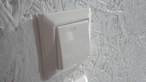

The garage light switch is making the light flash on and off as shown in the GIF. At the same time I can hear the sound of the relay (zwave switch) going on and off.
This has been stable for many months.
I noticed today that I stops flashing if I turn the switch off via the HA switch, but triggers back to flashing state once the PIR detects motion.

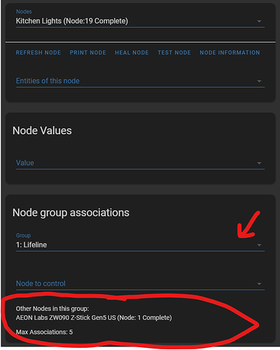

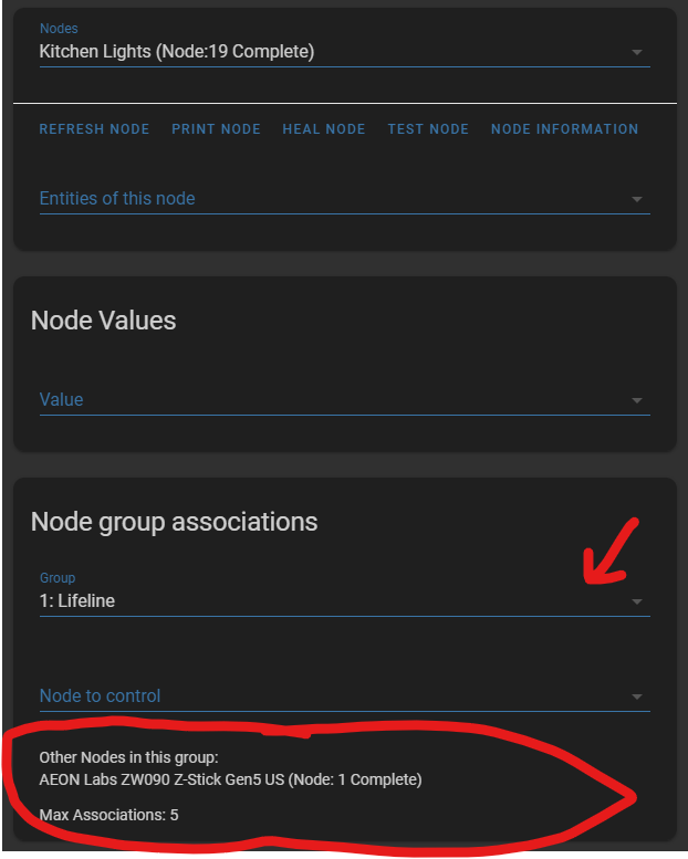

It will be at the bottom of your node in the zwave control panel.
Make sure for the light switch that only node 1 is associated with it. There may be multiple groups other than Lifeline listed. You’ll want to inspect them to find the association then select the PIR from the Node to Control and click Remove from Group

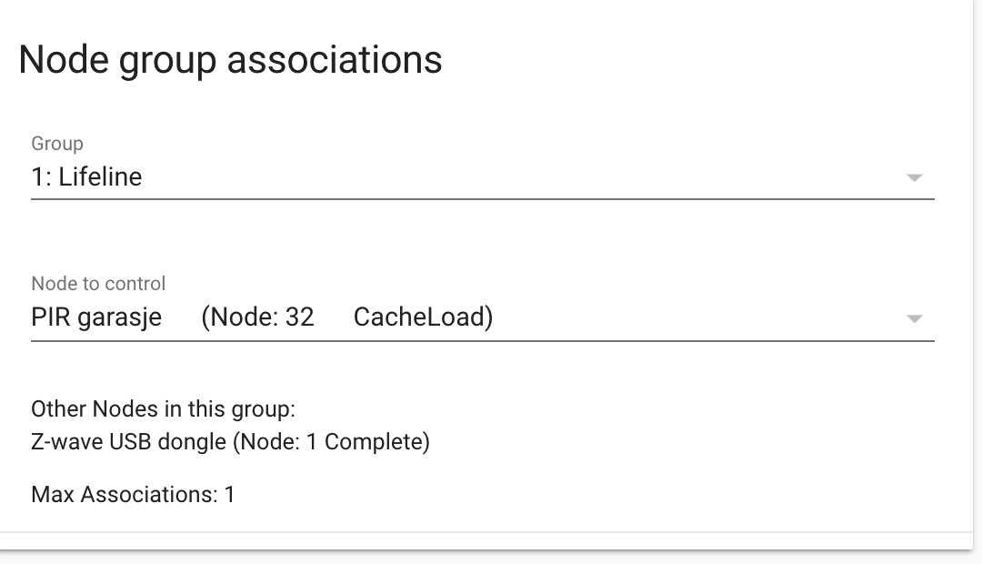

It says “No other nodes in this group”, so there is no option to remove it from the group either…?
Am I missing something here?

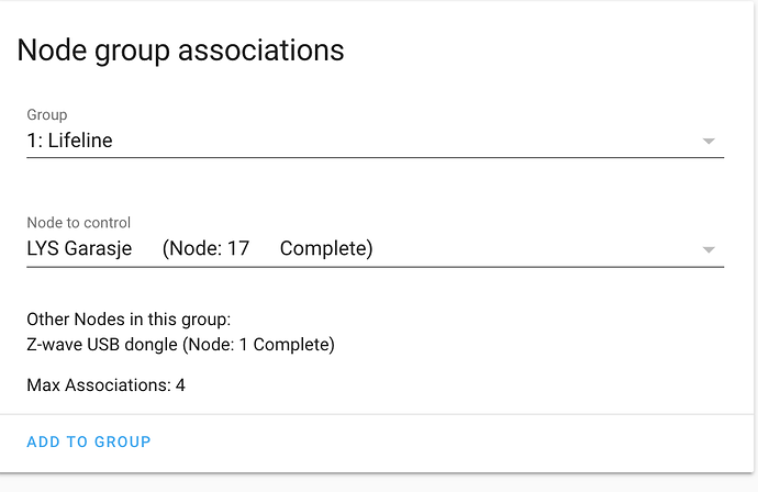

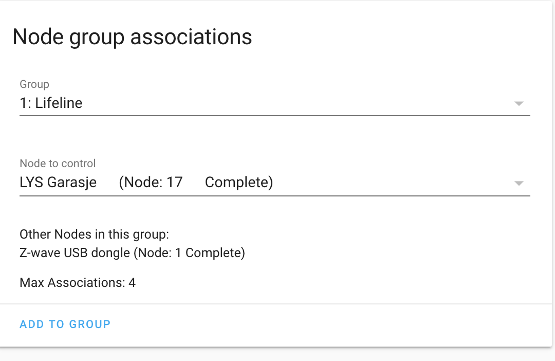

This is the other way around (selecting the PIR as node). Here action button Add to group is visible.
Did you check if there’s more than 1 group on the devices?
For the Light switch I have
1: Lifeline
2: Basic Set
3: Group 3
The PIR:
1: Lifeline
2: Control Commands BASIC_SET
3: Send Notification Report
4: Send Sensor Binary Report
