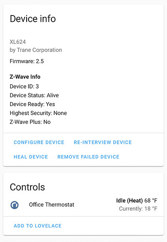

I am trying to move from my Vera Z-wave controller to HA. After removing two devices from Vera and moving them to HA, I was able access both in HA, but with different quirks.
Focusing on the one issue, my thermostat reports the current temperature using a Celsius reading, but calling it Fahrenheit.
Since I have a docker setup of HA, I installed zwavejs2mqtt. With that, I can see zwavejs2mqtt recognizing the current temperature as being reported in Celsius. However, instead of HA converting this to Fahrenheit, it just labels it as Fahrenheit.
It is interesting that the temperature I set the thermostat to is correctly displayed, but not the current temperature reading.

In the zwavejs2mqtt z-wave settings, there’s a preferred scales setting. What happens if you set temperature to F?
Be sure to click “Save” at the bottom. Then click on the “Refresh” button next to the “Multilevel Sensor” text as seen in your screenshot. Does that change the unit and value for the Air temperature to F?
If that works, then you might need to reload the Z-Wave JS integration for the unit change to be recognized. If the Air temperature reports in F, then it should fix the climate entity.

I reinterviewed and had the same problem, then excluded and reincluded in the zwave network and have the same problem.
I set Fahrenheit as the preferred scale and restarted the whole server and it did not fix the issue. Could not find the multi sensor after re-adding the thermostat so that is why I restarted the server instead.
This is weird, I can see the multi sensor again in zwavejs2mqtt. It showed the Celsius temperature to start, but after hitting refresh, it showed the number value in Fahrenheit, but continuing to show the Celsius label. In HA however, it now shows up correctly, which is all I care about.
I think that fixed the issue for me.

After restarting HA, the fix was persisted. However, now in zwavejs2mqtt, I am seeing the correct label of F with a correct Fahrenheit value.
Understood. That is consistent with what I am seeing.
