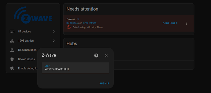

Here is what I get when I try to configure
I cannot type in the USB Device Path.
When I hit submit I get this even if I delete all the data

Can someone point me in the right direction to get to the configuration to set the location of the device.
I have gotten here if I dont use Assistant but it is URL.
EDIT — I found where to Edit the Device (Add-on Z-wave JS) but it only has ttyS0. Looking at the VM and the hardware configuration.
EDIT – I found the problem. I forgot to add the virtualbox group to user when I reinstalled virtualbox.
