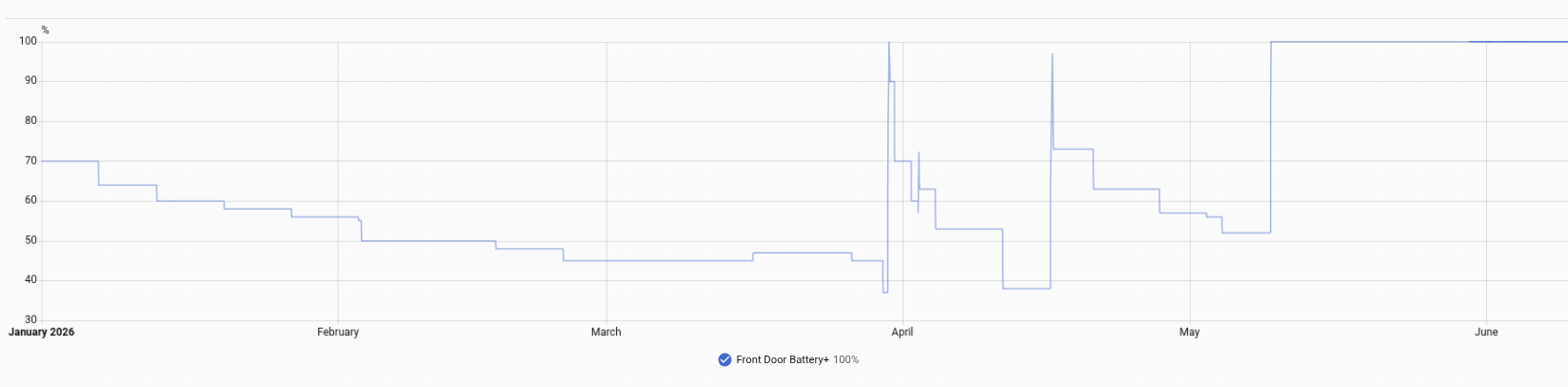

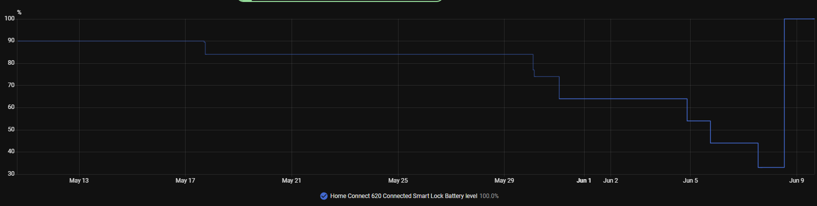

What is interesting is my battery graph. It shows random dramatic drops in battery level but at other points its stable for multiples days.

I see things like that when I'm using rechargeable batteries. For instance:
April and May I was using some rechargeable batteries, but I was on some standard Energizer batteries before that and switched back again during the change I did in May.
No I am not using rechargeable batteries, but I was considering them as a temporary solution while I sort out what is killing the batteries so fast. I have used standard AA alkaline batteries utilizing duracell and energizers.
