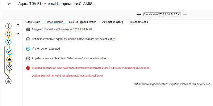

Hello, I’ve a probleme with the Blue Print,
Befor it work well but since 1 week it don’t work :
The detail off the variable
Since today i have exactly the same problem.
What i noticed also is that since this morning i am running an updated Zigbee2MQTT version which now exposes one additional entity being Calibrate.
If i publish a message to mqtt setting the temperature by hand it works great.
ah thin, what message must we send manually to send the value?
Can you think is it possible to create manual automation while the problem is resolved?
Thank U
back to HA 2023.10.3 and it work
I’m trying to make a very basic automation standard HA. No luck so far.
using developer tools this is the zigbee2MQTT message to publish an external temperature reading.
service: mqtt.publish
  qos: 0
  retain: false
  topic: zigbee2mqtt/Aqara Radiator/set/sensor_temp
  payload: "22.1"
Hi there - there was a small bug in my blueprint where the wrong selector entity was selected.
More Details: This was caused due to the recent z2m version where a second selector entry (calibrate) has been introduced. The updated blueprint should now select the correct entity based on the existing of the option “external”
