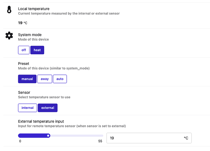

In the Zigbee2MQTT UI, I can see that my TRV exposes an external temperature input:
But if I go to the device’s page in Home Assistant, I can’t see any entities for the external temperature input.
How can I make that entity accessible?
