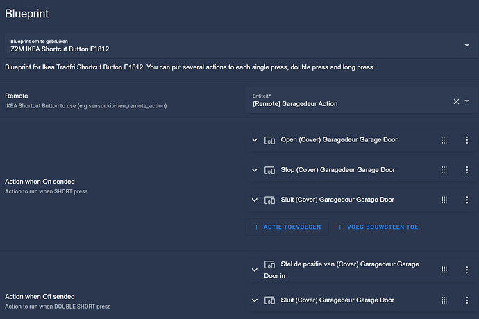

Hi @Danieldz ,
Thanks for the template!.
The short button press works like a charm, i’m just having some difficulties with the double press. Do you have any idea why this doesn’t work?.
alias: Afstandsbediening Garagedeur
description: Open/Sluit de garagedeur of open deze voor 50%
use_blueprint:
  path: Danieldz/z2m-ikea-tradfri-shortcut-button-e1812-universal-actions.yaml
  input:
    button: sensor.remote_garagedeur_action
    single:
      - device_id: be746991fa9bb6872733a925242b39dd
        domain: cover
        entity_id: 44ad320a7eaa6e10b981cbd4dcbbb607
        type: open
        domain: cover
        type: stop
        domain: cover
        type: close
    double:
        domain: cover
        type: set_position
        position: 50
        domain: cover
        type: close
