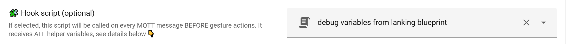

1.0.1 - Hook script
  • Added selector for hook script: This script will start on each gesture and receive all availible variables
  • Added knob_id variable
:puzzle_piece: Hook script
You can select one script that will be triggered on each gesture and will receive all variables:
