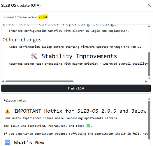

I run my SLZB06p7 on 20240716 / 2.9.4 and I don’t have any disconnect issues. 80+ devices in the mesh.
thanks for your reply, i have the latest…3.0.6, not sure i wanna downgrade…
If you are having issues I would give it a try.
i only see 2.9.8 and 2.8.7…i dont have 2.9.4 option
