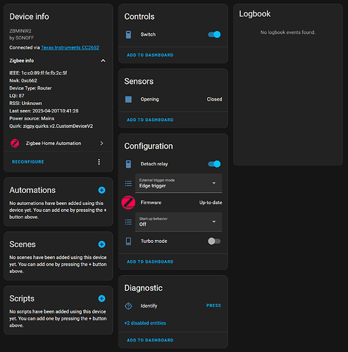

Tried this but my ZBMINIR2 switches are not detected when i want to select a ZBMINIR2 device that is in Detach relay mode. so i cannot use this?
Deice info:
ZBMINIR2
by SONOFF
Connected via Texas Instruments CC2652
Zigbee info
IEEE: 1c:c0:89:ff:fe:fb:2c:5f
Nwk: 0xc662
Device Type: Router
LQI: 87
RSSI: Unknown
Last seen: 2025-04-20T10:41:28
Power source: Mains
Quirk: zigpy.quirks.v2.CustomDeviceV2
