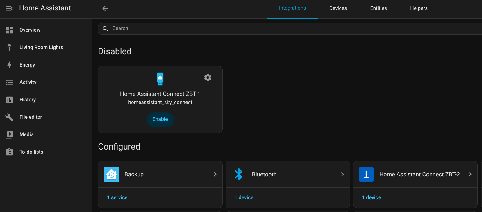

I’ve disabled the ZBT-1 add-on, and disconnected the ZBT-1 and everything appears to work but I won’t be deleting it yet until the following issue is resolved as I really don’t want to re-pair all my kit.

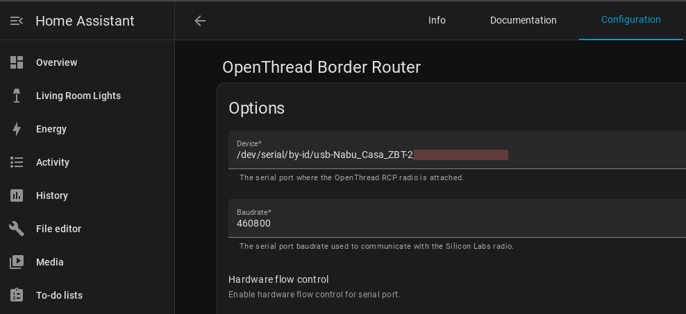

OTBR “add on” shows ZBT-2

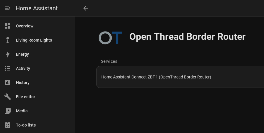

OTBR “service” shows ZBT-1 (even though its disabled and not even connected) I am unable to add the second screenshot as I am a “new user” :frowning:

I think that is just a name string that HA gave the OTBR Integration entry when the entry was created. You can click on the 3-dots and rename it if you like, but it should still work as is. This integration is communicating with your existing OTBR AddOn, and it will continue to communicate with your OTBR.

Assuming the firmware flashing worked OK, all you need to do is stop OTBR AddOn, unplug the ZBT-1 and then plug in the ZBT-2 and configure the OTBR AddOn to use the ZBT-2 as you have shown in the screenshot, startup the OTBR AddOn and everything should work.

Thanks Wally. Can you tell me where I change the USB binding? (My “service” seems OK and its pointing at ZBT-2. Its the OBTR integration showing the previous ZBT-1 even though the ZBT-1 add-on is disabled and the device itself ZBT-1 is physically removed)
What Wally means is to change the OTBR AddOn’s config to use the ZBT-2 which you show with the above screen shot (/dev/serial/by-id/blah blah).
Its just a name that HA came up with when it first created that entry for the OTBR Integration. You need not worry that it has ZBT-1 in the name. The OTBR Integration doesn’t care about which USB device is being used, it only cares about which OTBR AddOn it needs to talk to.
