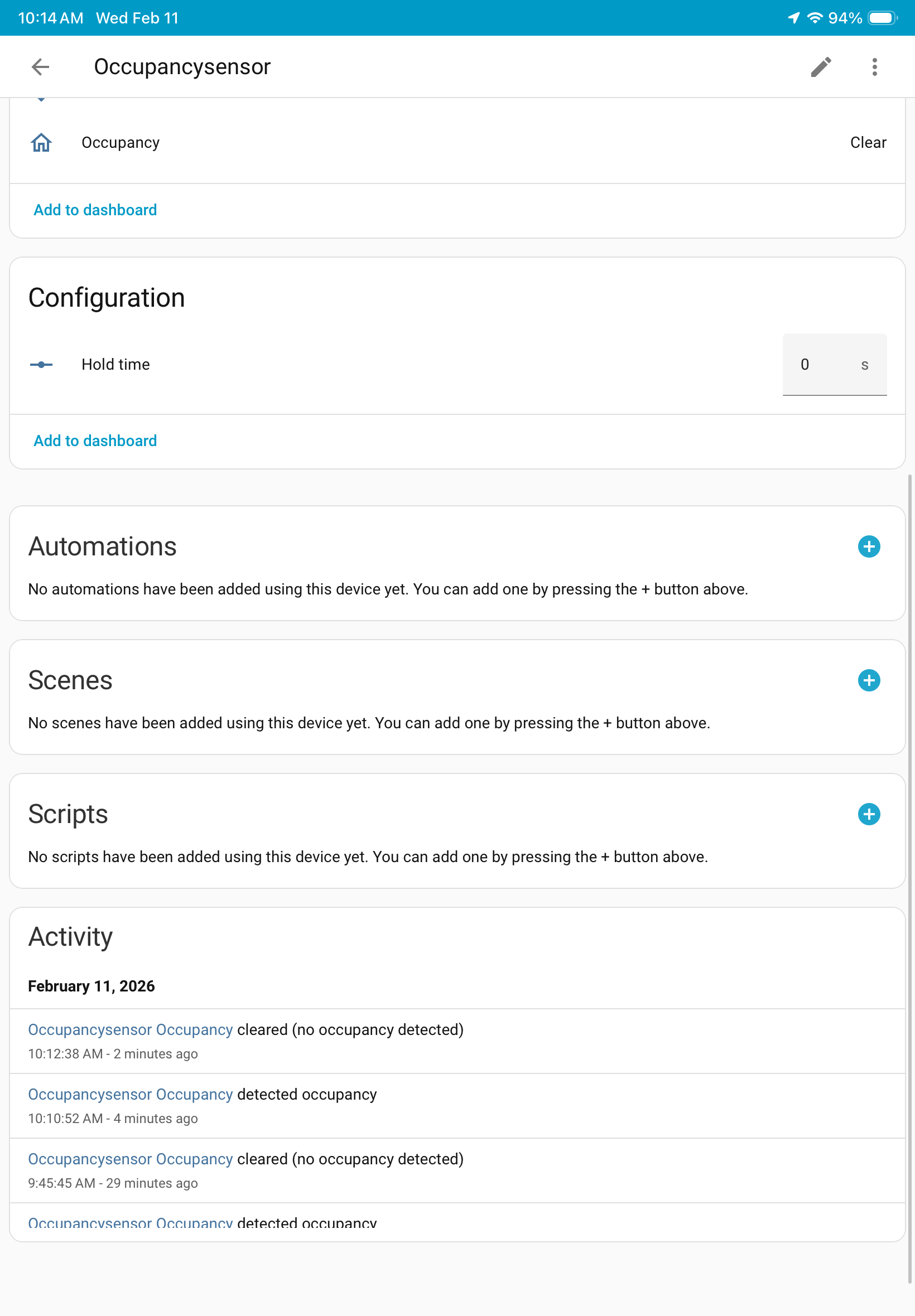

Plugin Download
Plugin Configuration

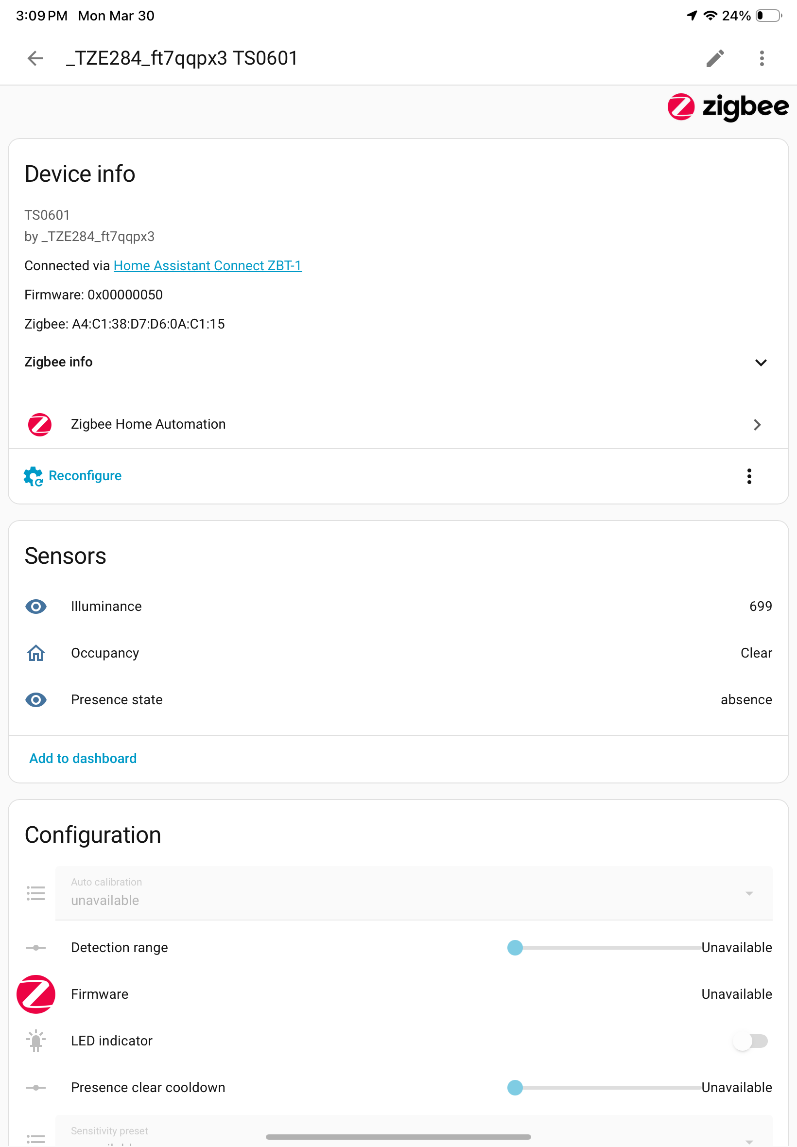

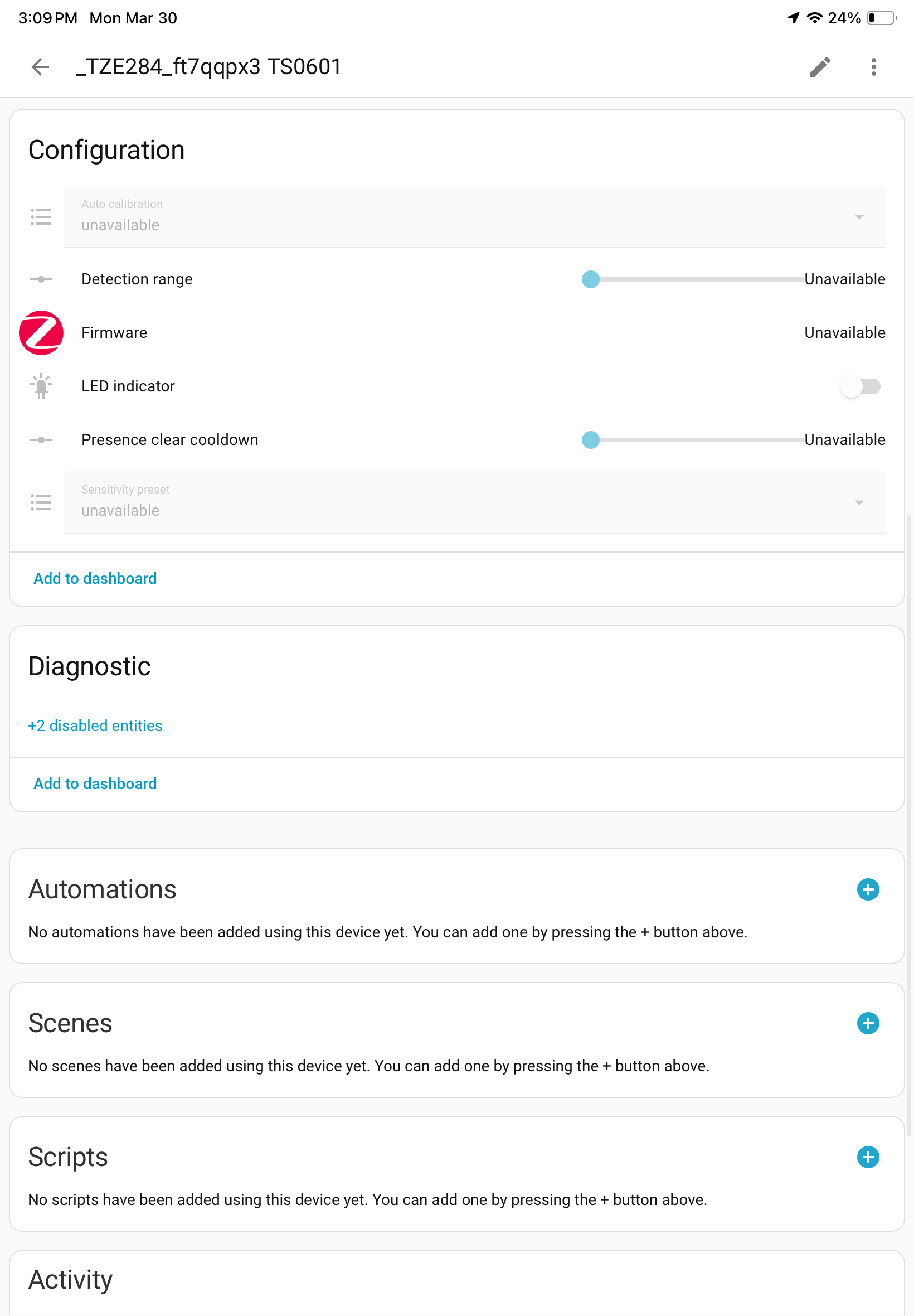

For ZHA users:
1.Place the plugin files in HA’s plugin directory (follow README instructions if needed).
2.Restart Home Assistant.
3.ZHA will automatically detect ZMP-1Z.
4.Click Add Device, then long-press ZMP-1Z button to enter pairing mode.

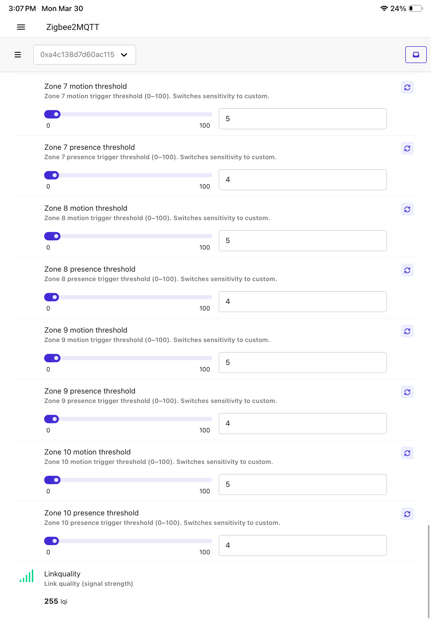

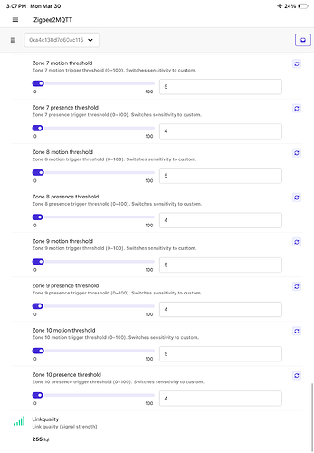

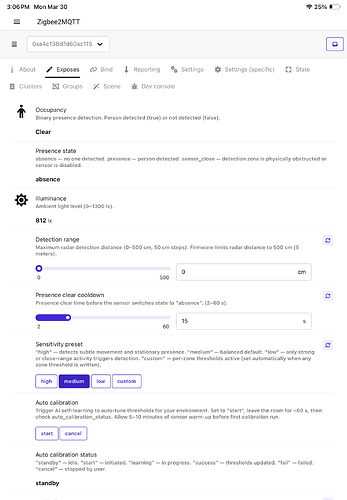

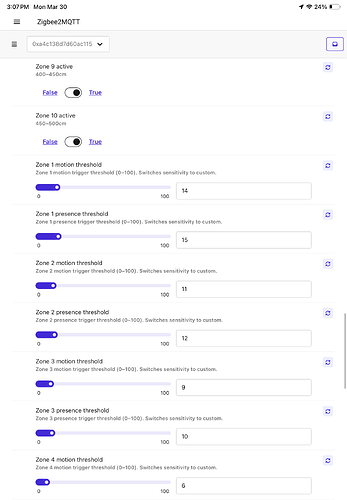

For Zigbee2MQTT users:
1.Place the plugin files in Zigbee2MQTT configuration folder.
2.Following README instructions.
3.Restart Zigbee2MQTT.
4.Enable pairing mode in Zigbee2MQTT and long-press the ZMP-1Z button to pair.

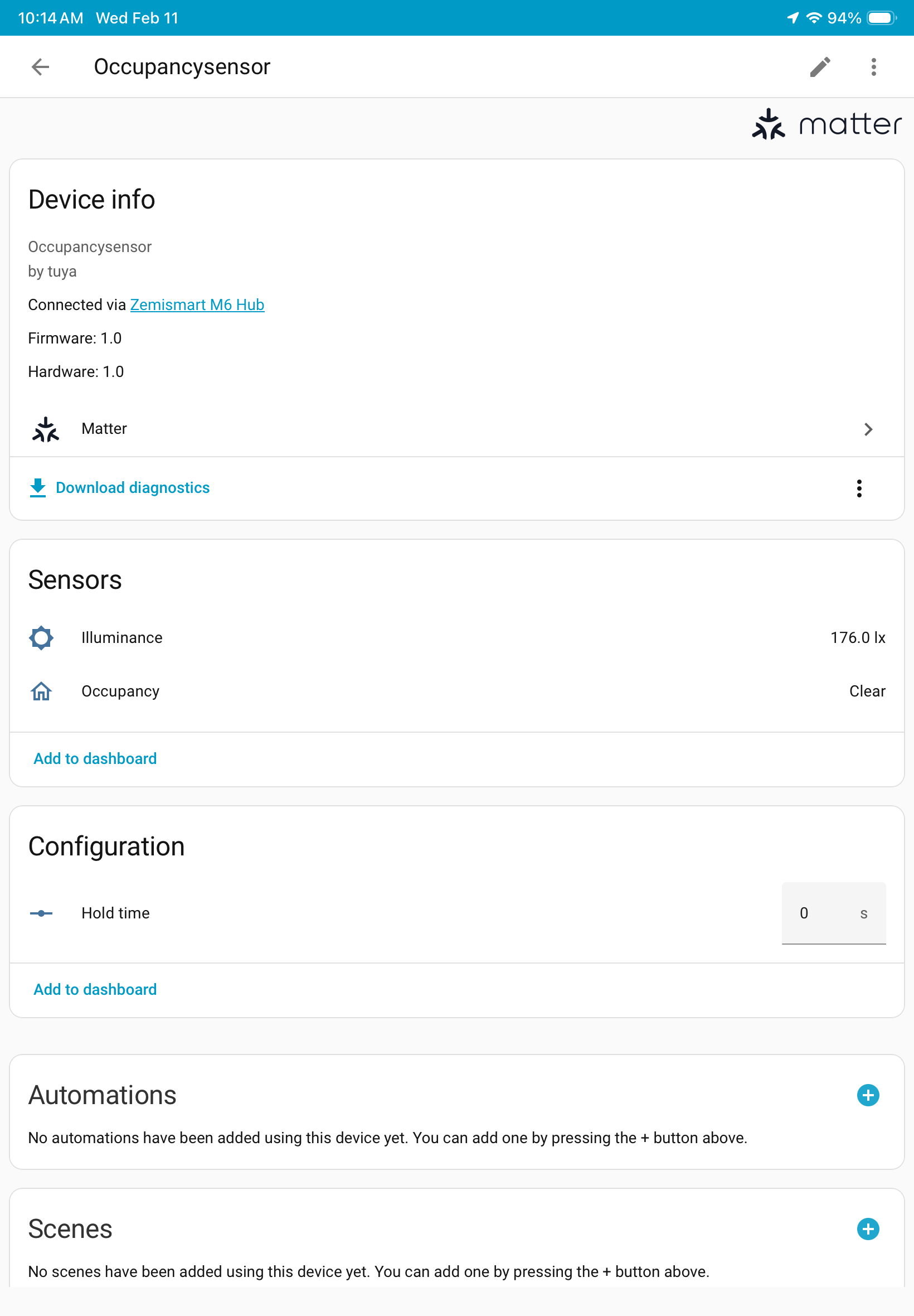

Additionally, if you have our M6 Matter Gateway, you can sync ZPS to Home Assistant without a configuration file. Learn more about the M6 Gateway here: Zemismart Matter Zigbee Smart Home Hub Matter Bridge Integrates with Home Google SmartThings Home Tuya Control
