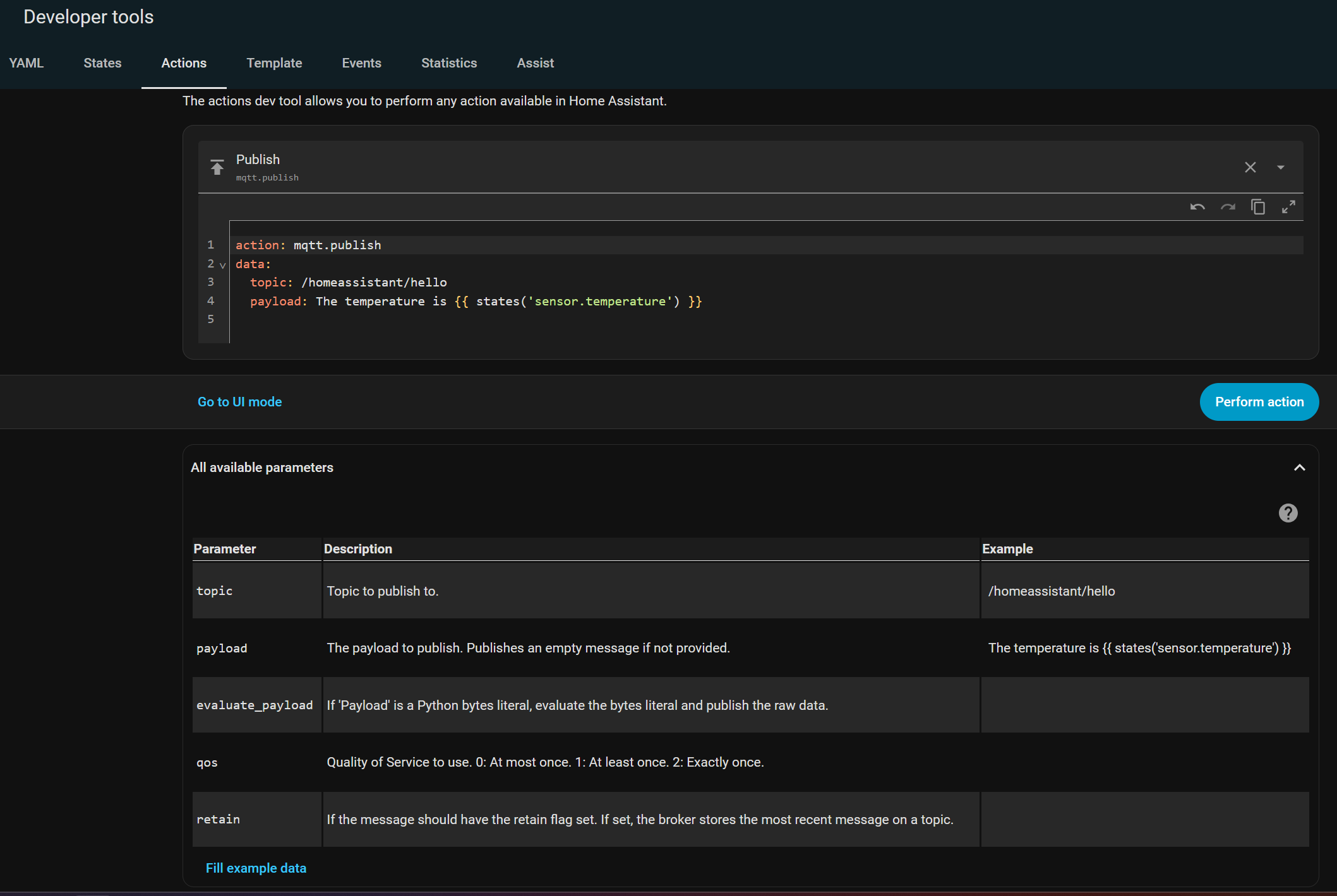

Did you try using Developer Tools > Actions?
If you choose mqtt.publish in the selector dropdown, whilst in YAML mode, it will show you the correct syntax to use (Hint: I think it’s because payload_template was deprecated some time ago. Now the correct key is just payload.)
