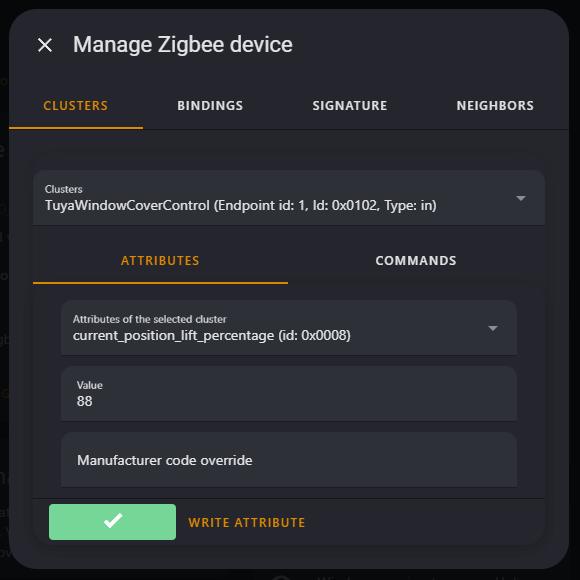

It resets to 88 after every open/close action.

User @sormy has a solution for this (although its not working 100% correct, its better than nothing):
  1. in ZHA > Specific device > Click Manage zigbee device
  2. In clusters tab pick TuyaWindowCoverControl
  3. Then pick attribute cover_inverted, set value “Bool.true”, click “write attribute” button
  4. Then pick attribute motor_direction, set value “Bool.true”, click “write attribute” button
  5. Reload zigbee integration
  6. You might need to full open/close shades once in HASS to synchronize some state.
