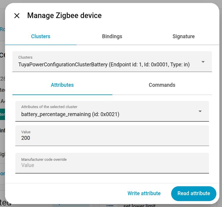

I'm using this ZHA quirk (from your github repo). It works generally quite well. I'm also happy with the ZMP1 devices.
One issue I have run into is that 2 of my 3 devices always report the battery percentage as 100%. I did direct Zigbee queries, and it always reports 200 for those devices, which I believe is intentionally scaled 2x. So, it seems like this is either a hardware issue or a reporting issue on the device size of the Zigbee protocol.
I know of at least one other user who has the same problem. Is there a workaround or a firmware update for this?
The real-time status always shows either opening or closing. Is it possible to know when the motor is stopped?
yes, We have identified this problem and are working on resolving it.
all 3 work like that?
Yes, all 3 show the most recent movement status even though they are all stopped.
Do you mean the problem of the battery percentage or the problem of the real-time status?
could you show video to check this issues?
and also the 200% battery level.
I'm using your ZHA quirks file to interface directly with HA. No Tuya hub at all.
HA shows the battery level at 100%. If I query the battery percentage attribute directly with the HA Zigbee dialog, it shows 200. I think that attribute is reporting half percents, so 200 corresponds to 100%. In any case, it has not dropped at all in the few weeks I have been using the device. Another device does show slow decreases in the percentage.
