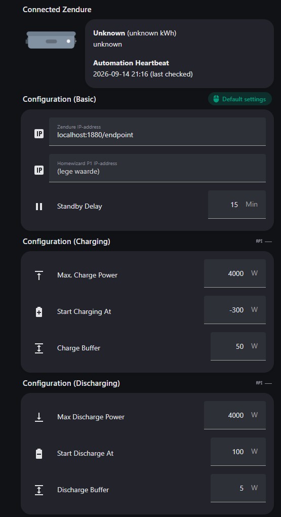

In the Gielz dashboard i placed localhost:1880/endpoint and tested with 127.0.0.1:1880/endpoint
No matter wat i try it’s not working.

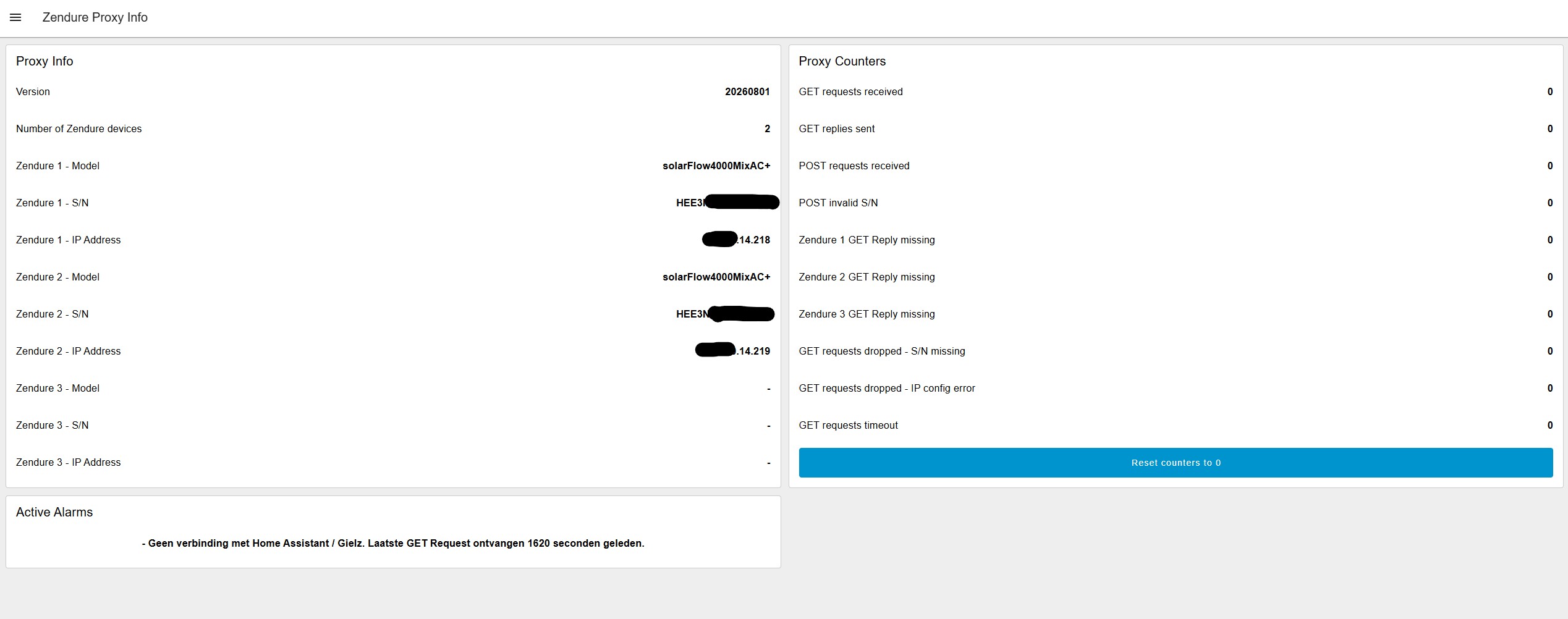

When i go to the url: :1880/endpoint/dashboard/zenproxyinfo it shows the dashboard below, and says “No connections with Home Assistant / Gielz. Last GET Request received xx seconds ago”
Below the settings in the Gielz Dashboard

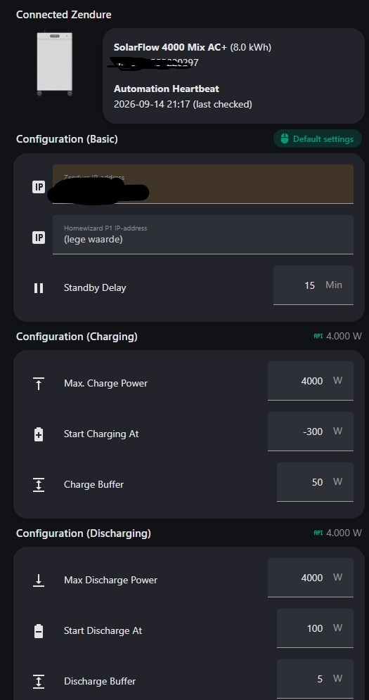

With just a single battery

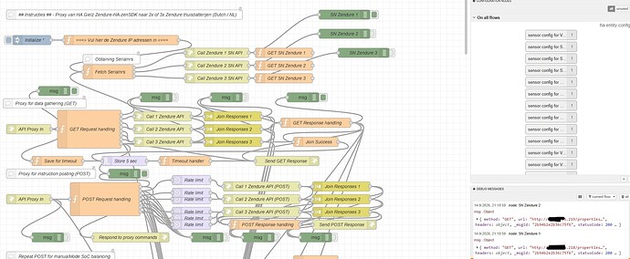

And below the nodered screenshot
In this situation localhost does not work.
You should use homeassistant.local, [where the server name of your HA is ‘homeassistant’] or the real IP address of the HA machine.
Try
homeassistant.local:1880/endpoint/
Contrary to the instructions given in the documentation for the Zendure SDK Proxy you appear to be using, you should not need to leave the Node-RED App back door open either, since the endpoint provides authorisation-free access to all the http nodes.
