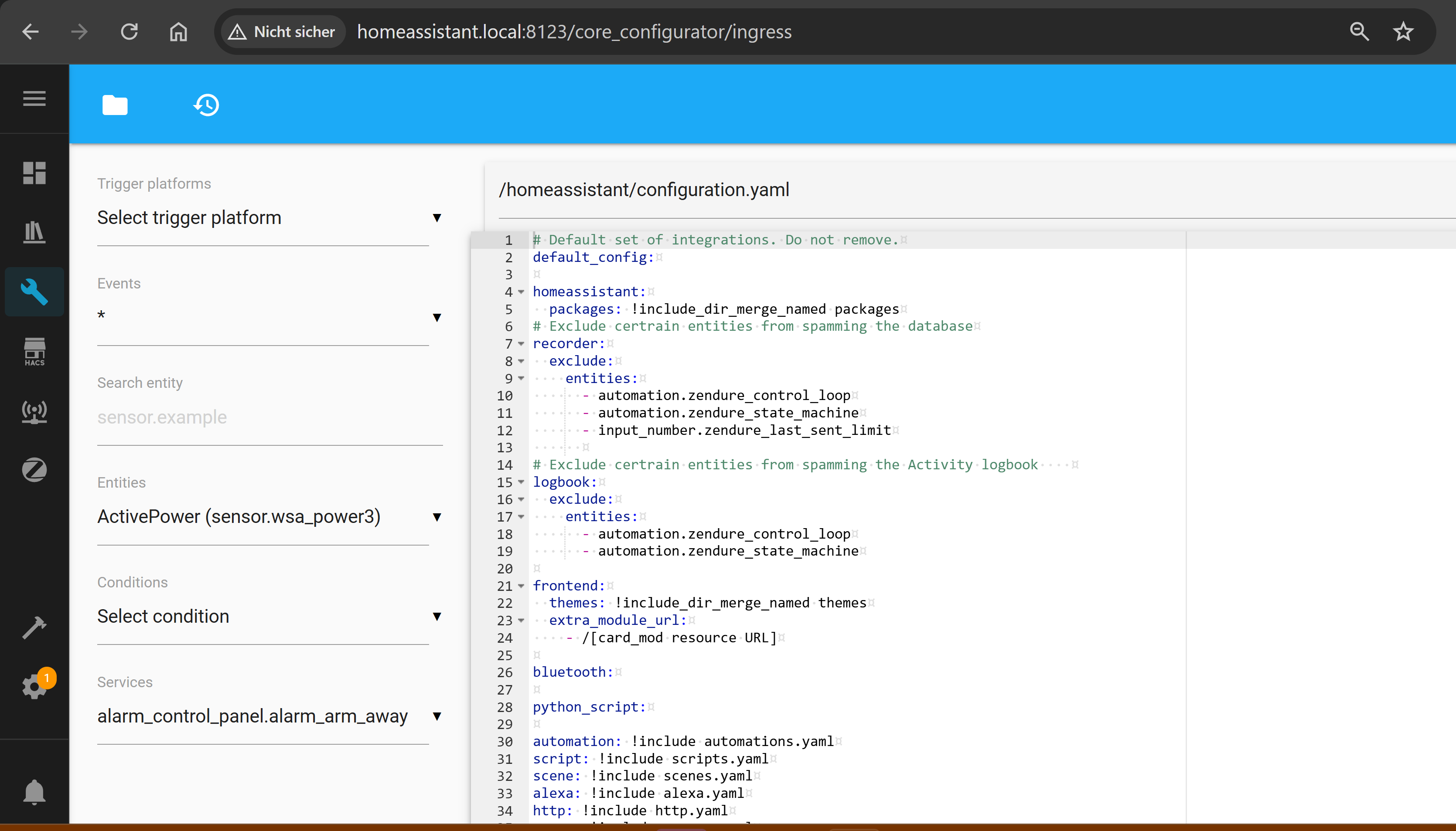

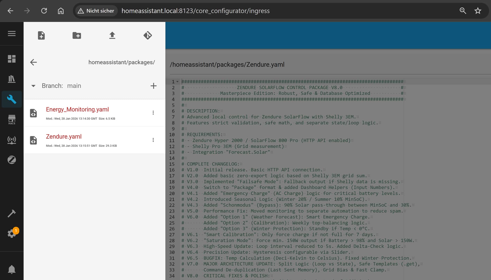

  • Save the two .yaml files listed below in a folder called packages in Home Assistant
  • Adapt the local IP Adress of your SolarFlow in the Zendure.yaml (e.g. replace the placeholder IP “192.168.30.91” with your IP)
  • Add the following to configuration.yaml:
# Configure Packages (Looking in the "packages" folder)
homeassistant:
  packages: !include_dir_named packages
# Exclude certrain entities from spamming the database
recorder:
  exclude:
    entities:
      - automation.zendure_control_loop
      - automation.zendure_state_machine
      - input_number.zendure_last_sent_limit
# Exclude certrain entities from spamming the Activity logbook
logbook:
  exclude:
    entities:
Zendure.yaml inside the packages folder:
#                   ZENDURE SOLARFLOW CONTROL PACKAGE 	                       #
# DESCRIPTION:
# Advanced local control for Zendure SolarFlow with Shelly 3EM.
# Features strict validation, safe math, and separate state/loop logic.
# REQUIREMENTS:
# - Zendure Hyper 2000 / SolarFlow 800 Pro (HTTP API enabled)
# - Shelly Pro 3EM (Grid measurement)
# - Integration "Forecast.Solar"
# STRATEGY (Managed by Logic Manager):
# - WINTER: Stop at 20% SoC | Bias 10W (Import) | Saturation 250W
# - SUMMER: Stop at 8% SoC  | Bias 0W (Zero)    | Saturation 250W
# NETWORK STABILITY:
# - Polling: 15s | Timeout: 30s | No forced updates (Anti-DDoS).
# COMPLETE CHANGELOG:

Did you add the .yaml in a folder called “packages”?
I don’t have a Hub2000 but it should be working since the SolarFlow 800 Pro is basically a Hub2000 with integrated battery.
yep, everything there
And your configuration.yaml contains:
homeassistant:
recorder:
  exclude:
    entities:
logbook:
  exclude:
    entities:
If so, then I am out of ideas atm. Are you on the laste HA version?
Entries in my configuration.yaml build - ha 2026.1.3
should be the problem: Setup of package ‘template’ failed: Invalid package definition ‘template’: expected a dictionary. Package will not be initialized

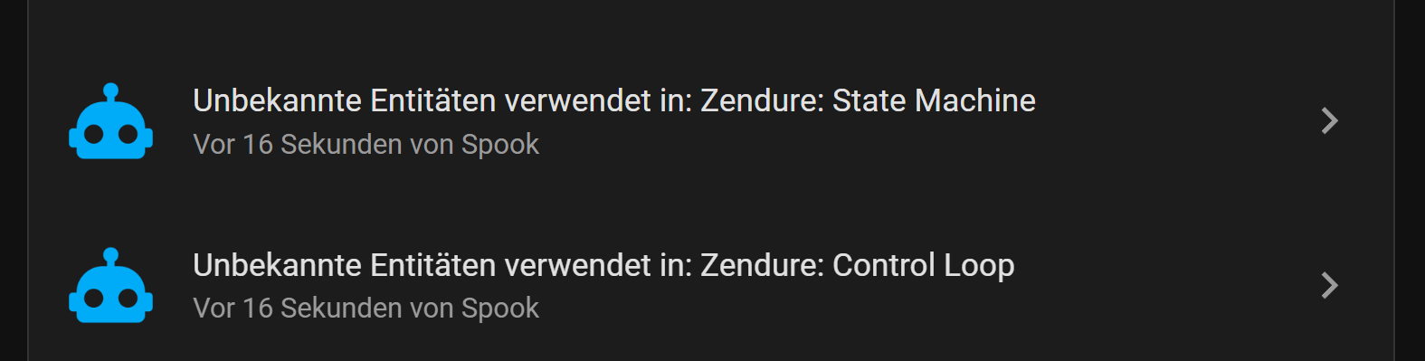

Setup of package ‘sensor’ failed: Invalid package definition ‘sensor’: expected a dictionary. Package will not be initialized
Hmm currently I am really not sure why this is happening at your end. Maybe someone else can help here.
here should be nearly the same issue (buts in french): Invalid config for ‹ template › at packages
Here is the github rep with the most up-to-date version: GitHub - Utini2000/Zendure-Solarflow-Local-HomeAssistant: Run Zendure SolarFlow 800 Pro devices locally without any cloud or internet access
