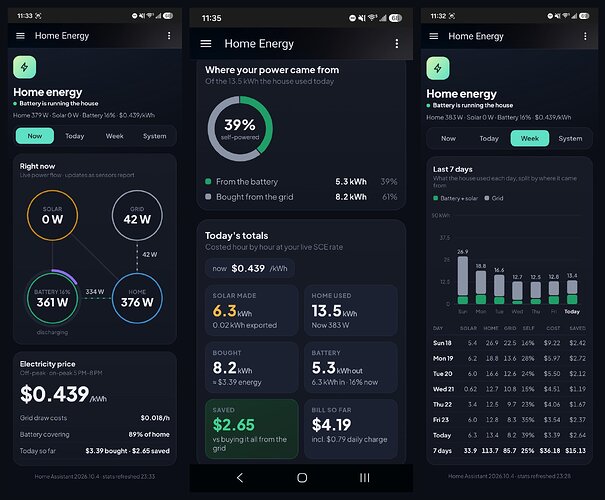

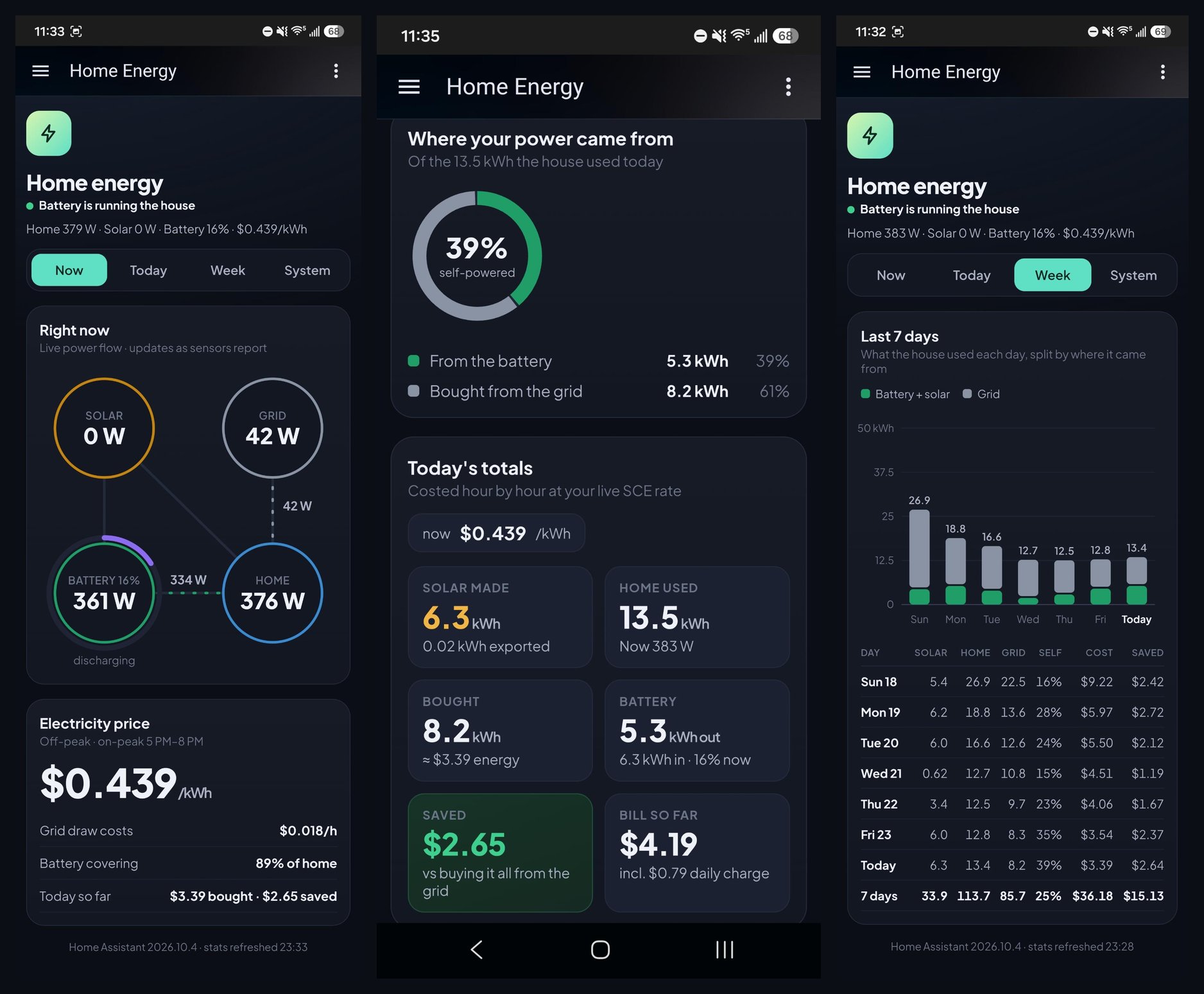

Here’s the Home Energy dashboard from the repo running in the HA companion app (live flow, today’s totals, last 7 days). It’s built to fit a phone with no sideways scrolling:
