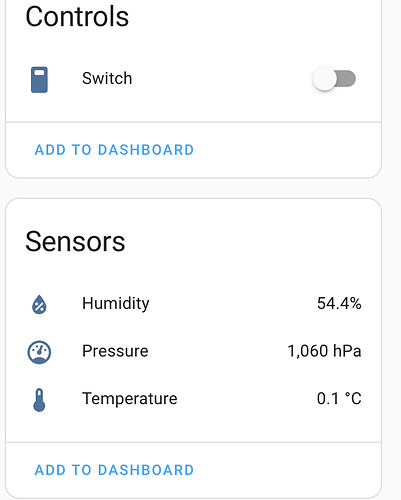

I have set up an end device that successfully provides temperature (0x0402), humidity 0x0405) and pressure (0x0403) clusters and these are all correctly picked up by ZHA (without a quirk).
However if I add an ‘analog_in’ cluster (0x000c) then it is simply ignored. I can see it in the signature:
but it does not show up as a sensor
What do I need to do to have the analog_in cluster show up?
