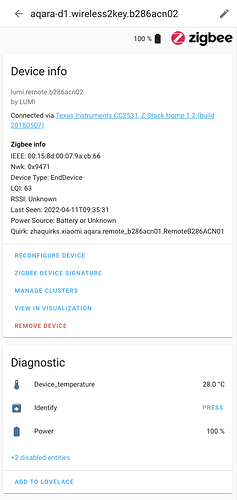

I have a new Aqara D1 3 button switch and a H1 2 button switch. Both of them are working with zha quirk: https://github.com/zigpy/zha-device-handlers/pull/1391 . The quirk was mainly so I can use them in decoupled mode but they also provide device automation triggers.
If you are interested I would appreciate the quirk being tested with more devices.

When I pair the Aqara D1 double key wireless wall switch (WXKG07LM), it shows up as the following:
